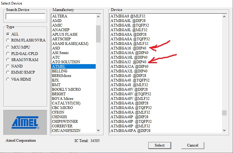

Good afternoon! Please add for the adapter QFP44_EX1 QFP44 K DIP40(3 in1) (only T48) the ability to program ATmega16, ATmega32 in the TQFP44 enclosure. Thank you.
p.S. It would be great if we added the ability to add chips to the user interface on our own. I don't know if it's possible... It often happens that there is a chip, but not in all cases.
