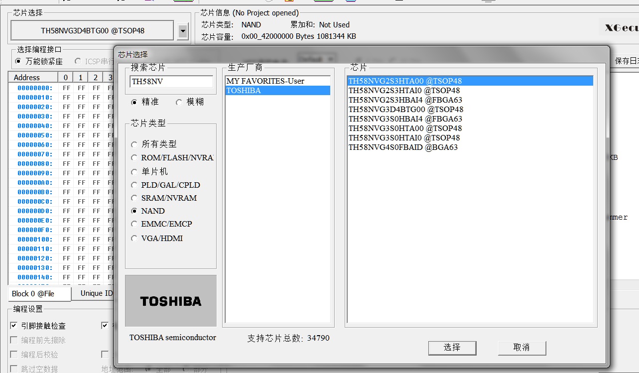

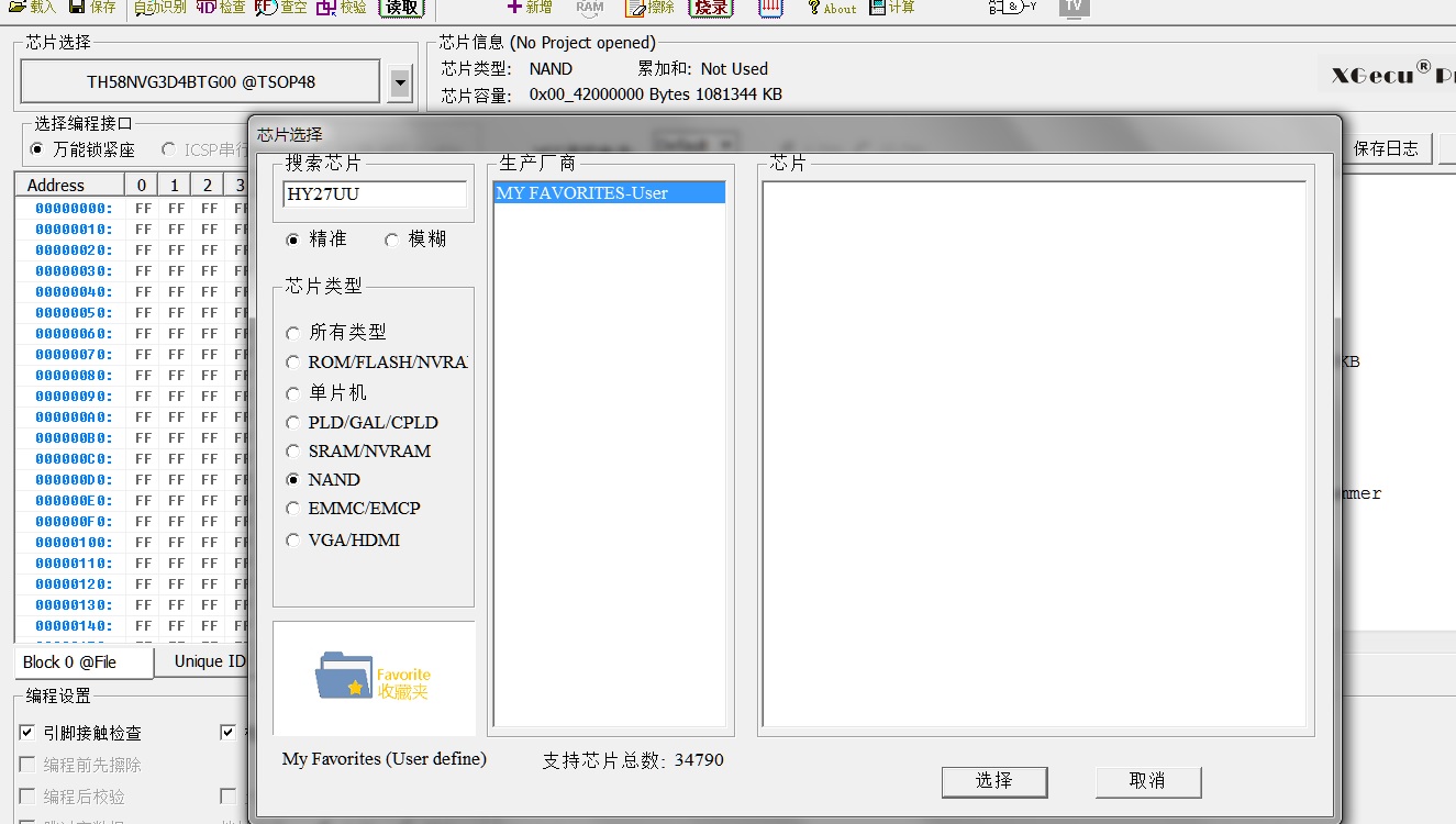

请问管理,为什么好多支持列表里有的芯片而在软件打开的列表里都没有
有发现同样问题的吗?譬如支持列表里有 HY27UU08AG5A @TSOP48                HY27UU08AG5M @TSOP48
2023-11-22 14:22
譬如支持列表里有   TC58NVG5D2FTA00 @TSOP48             TH58NVG5S0ETA20 @TSOP48
2023-11-22 14:25
等等好多支持列表里有的打开软件里都没有,这是怎么回事,这里面实际有支持3万多个吗?难道都需要自己手工添加?
有人解答一下吗

   As a User,                  You can try, starting Xegu application without  any programmer connected.
Select T56, choose the IC you need, enter it and verify device info. Close the program
connect the programmer and start the app,  it will in both cases show now the correct
adapter for T48.
I think, this is  a flaw in the software, i'm guessing.
Hopefully it will be solved in the next version of software that i feel a complete new version
with all those annoyances solved, or not :(
Hope it helps, if it works ok, is a workaround not a fix as i do not have the T48 or the proper adapters to check.  :)
回复 3# Albano.Matos
   Thx for your reply. I'll give it a try&hope a little hope;P
