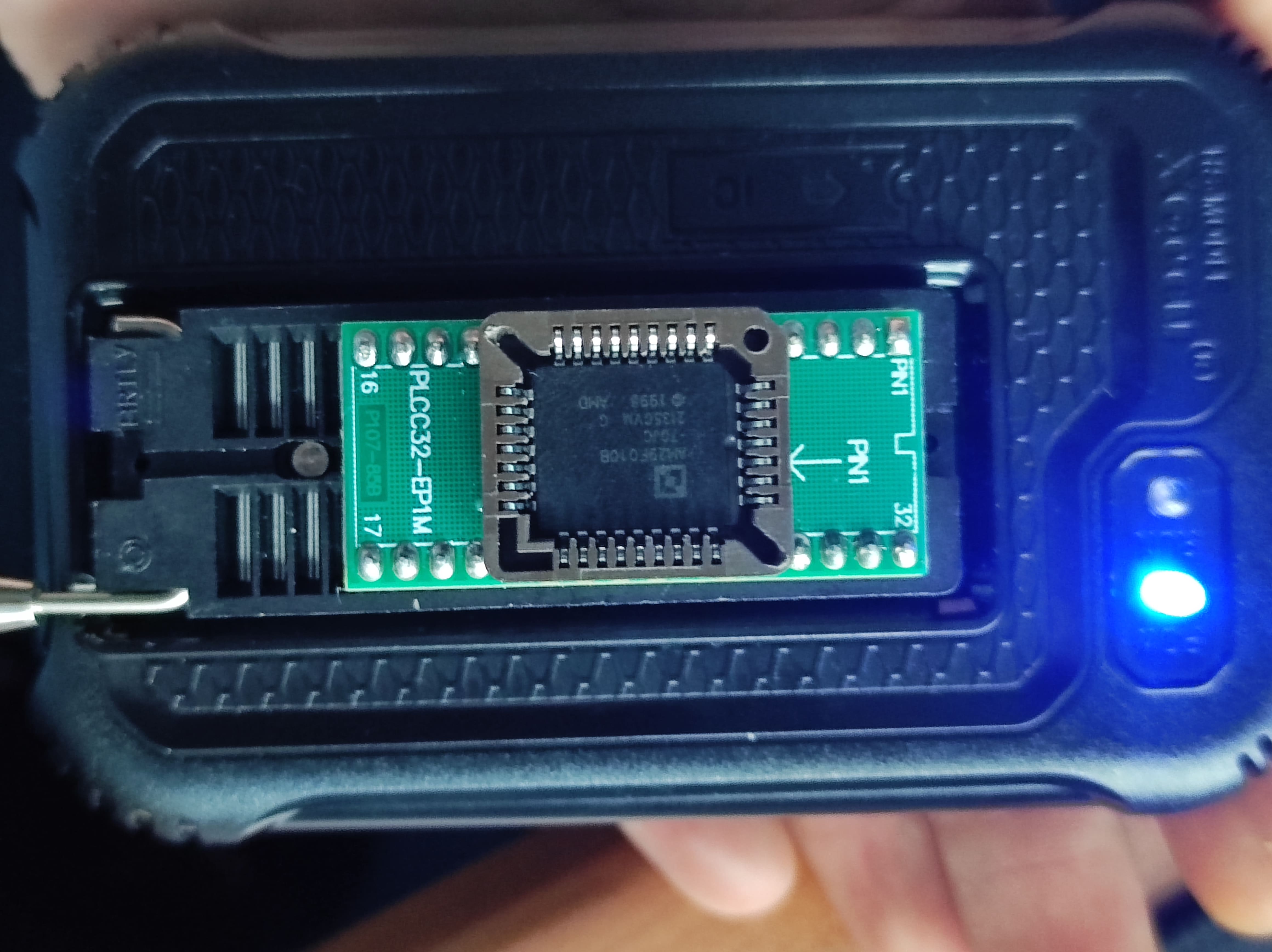

hi, I need help writing  in AM29F010B,
Blank Check, Check ID and Pin Detect: success.
I tried disable verify after, erase before and skip blank but got the same error.
Log output:
     Device : AM29F010B   @PLCC32
Pins Detected Passed!
ID: 0x 01 20 ......OK!
Erase  ...Succeeded. Time : 0.406 S
Programming FLASH ...
ERROR!  Address:0x000030   Buffer Data:0x08   Verify:0xFF
Programming  ...Failed
I am not able to write anything on this memory, i got the same error no matter what address I am trying to write
Solved. Turn out that the zip adapter had a short in two data lines.
This was the same issue that causes the problem covered in this other post:
http://forums.xgecu.com/viewthread.php?tid=1107&extra=page%3D1
