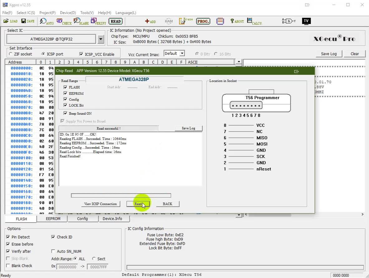

T56 via ISPinterface Atmega328P reading ok:
Readin OK
2023-4-25 14:51

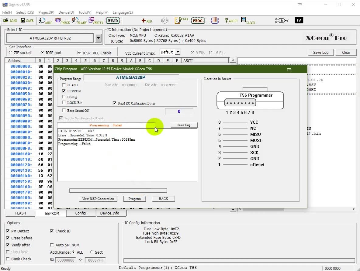

Butwhen writing, result is always error.
Writing Error
2023-4-25 14:51

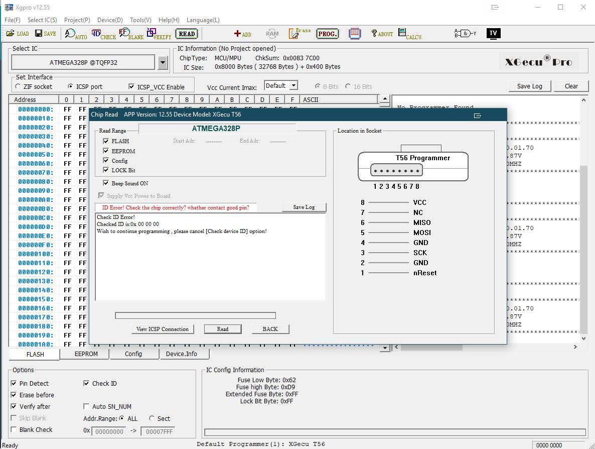

Every time after try to write (flash or eeprom), i can't  read ATmega328P anymore,programmer not recognizing Atmega.
Not recognize
2023-4-25 14:51

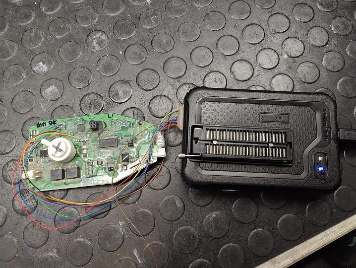

This is myPCB with Atmega328P.
With same wiring, same PCB, same dumps another  AVRISP MKII programer working ok.
Wiring
2023-4-25 14:51

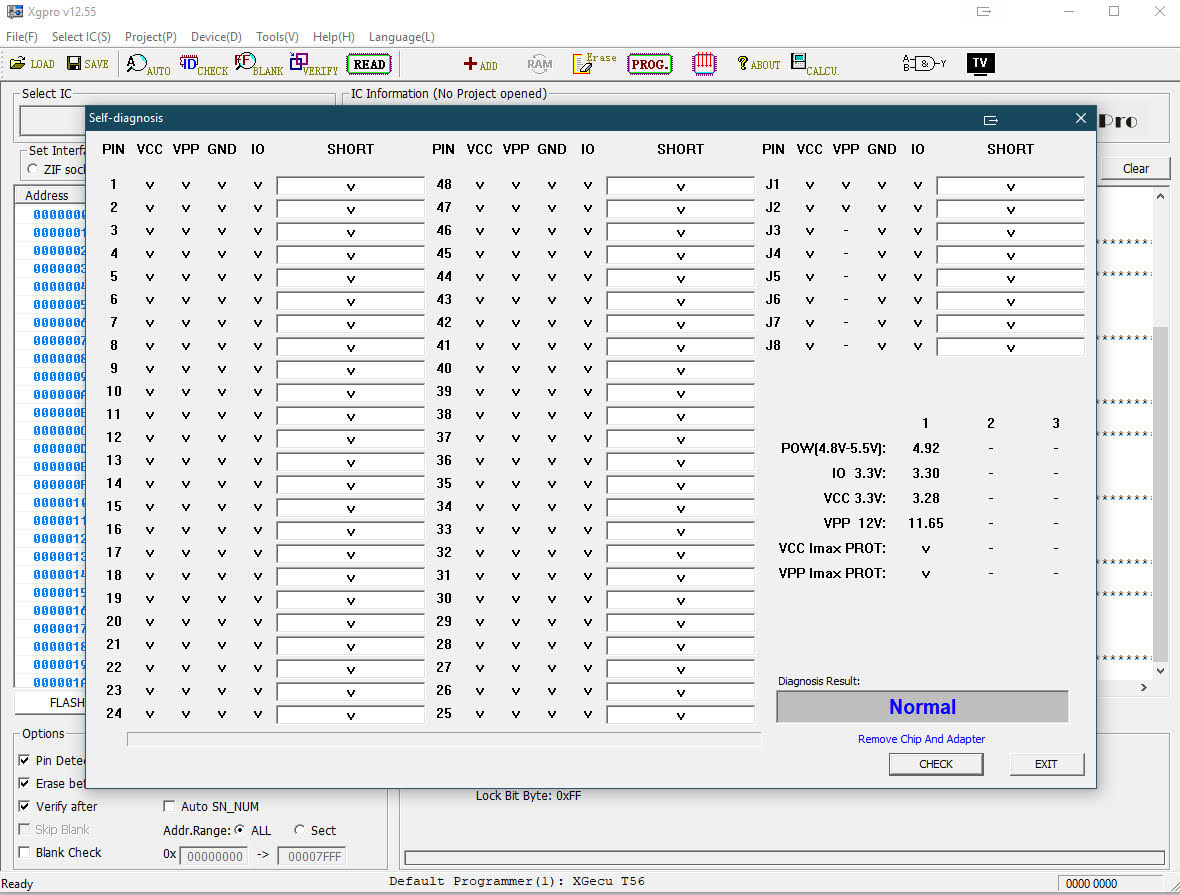

Programmerself test is OK.
Self Test
2023-4-25 14:51
