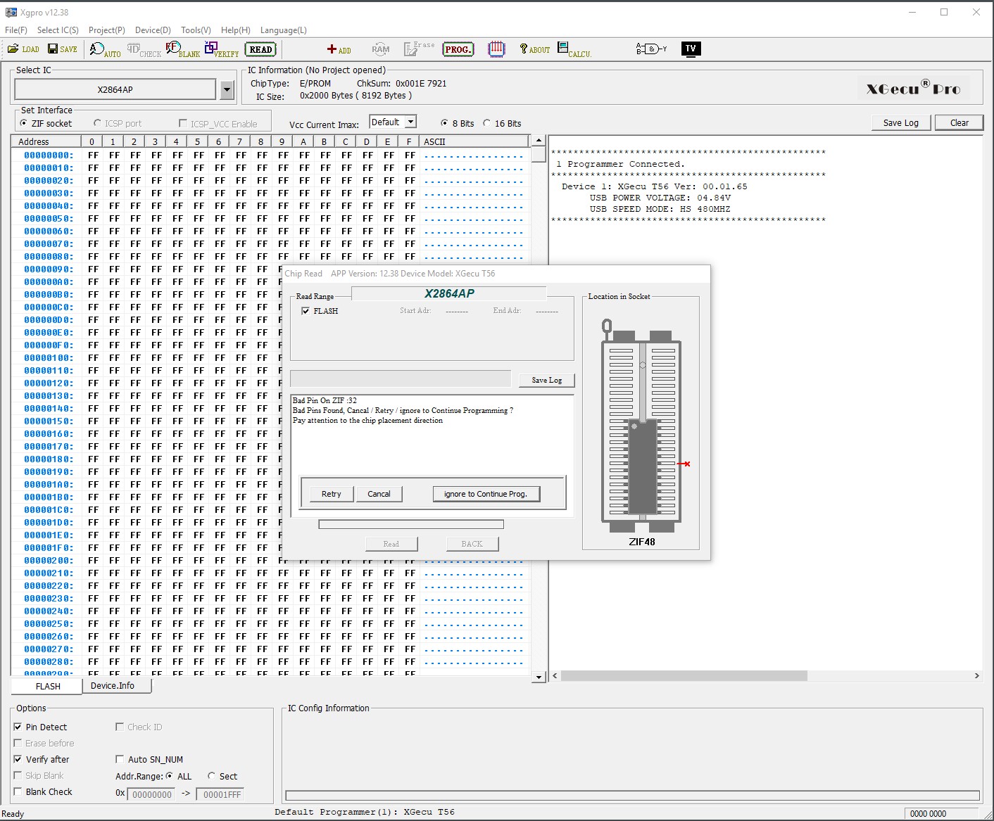

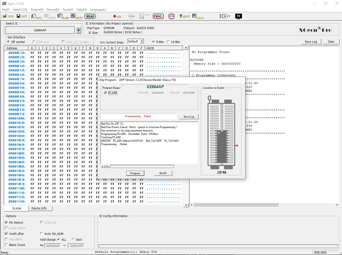

Thanks for your reply :)
Erasing by writing FF-filled buffer to the chip results in the same as erasing using some other 2864 chip profile with erase function present. Some bytes will not erase. See attached screenshot. Tried with several different X2864AP-45 chips. All of them gives the same result, so doubting it's due to faulty chips at least.
The X2864AP-45 is a 450ns chip (looks like I forgot a 0 in my first post). Is it possible to edit the programming parameters somehow? Would like to try with higher delays, unless you can can say for sure this isn't the problem, or got something else to try.
My T56 also appears to work perfectly otherwise. Programmed a bunch of 27 series EPROMs, PIC MCU:s and ATTiny MCU:s without problems since I got it a couple of weeks ago. It also passes the self test. |
