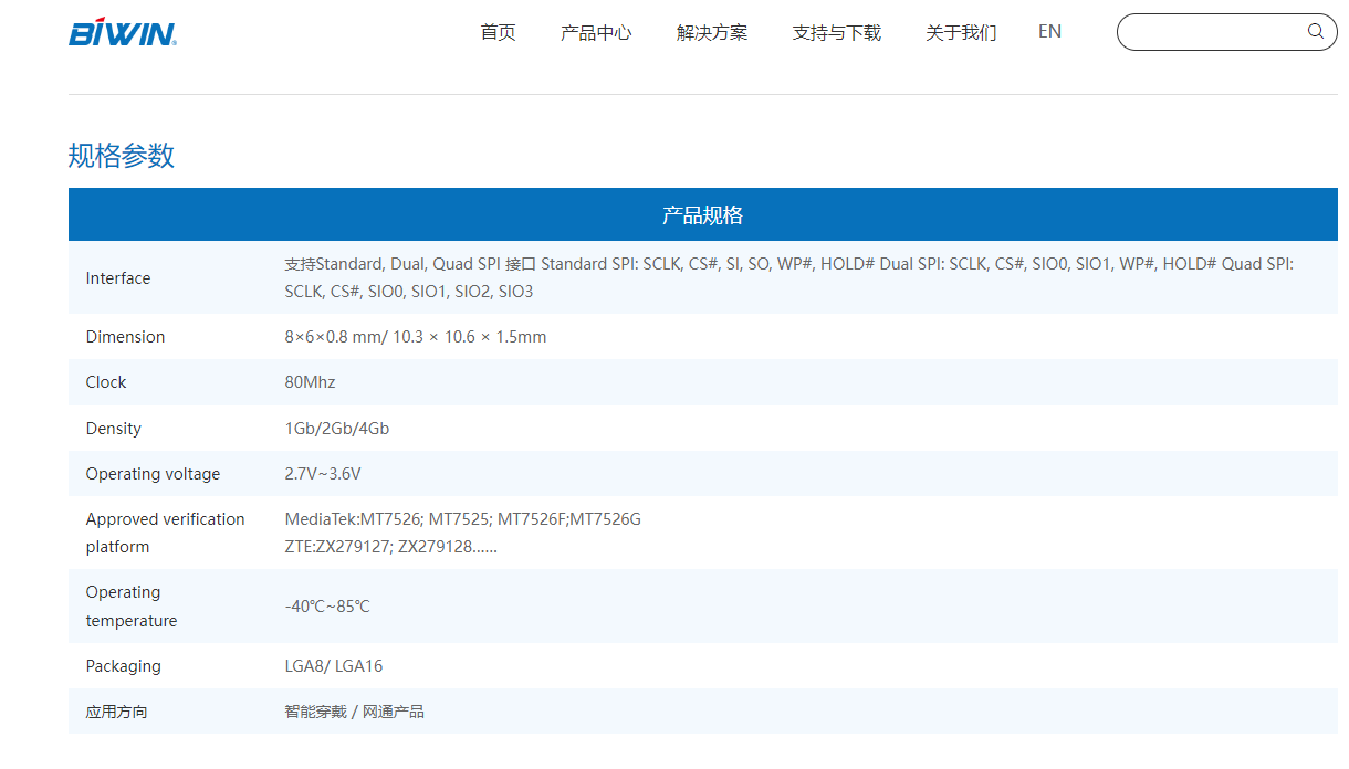

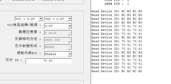

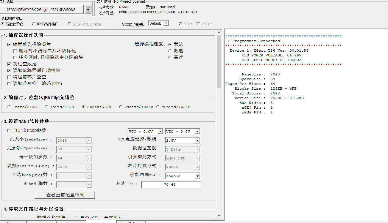

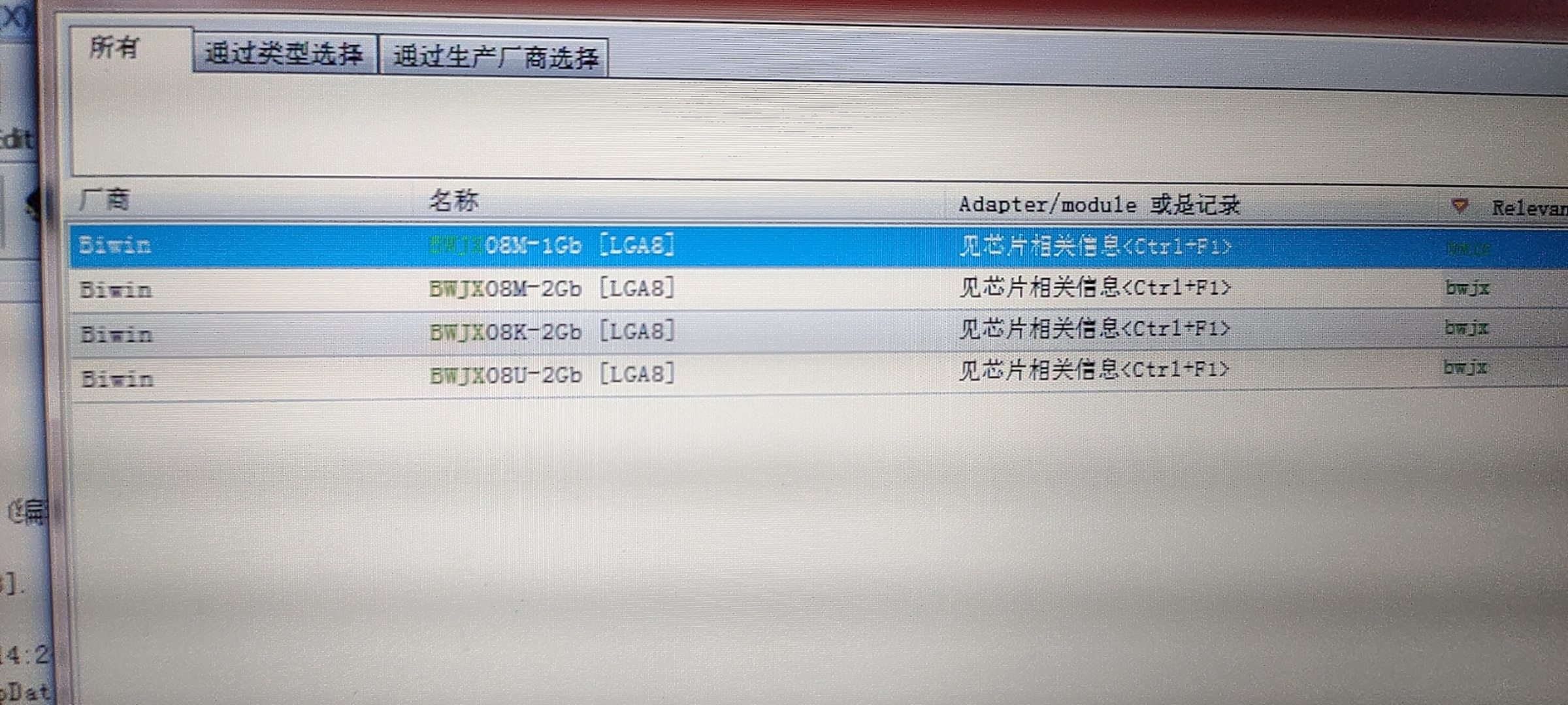

BWJX08K-2G这是一个BIWIN二封的spinand芯片,佰维不提供数据手册下载,这小众产品在互联网上也找不到信息。 ...
q519948746 发表于 2022-7-8 15:22

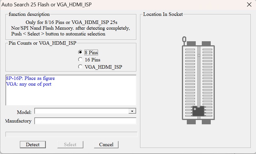

As an user:... Have you tried the auto search for SPI nand function recently added in 12.X software of Xgpro? 12.05 is latest available. Hope it's working good for you
Inside xgpro SelectIC(S) --> 25 Flash Detect , or just press 'auto', right side from save
