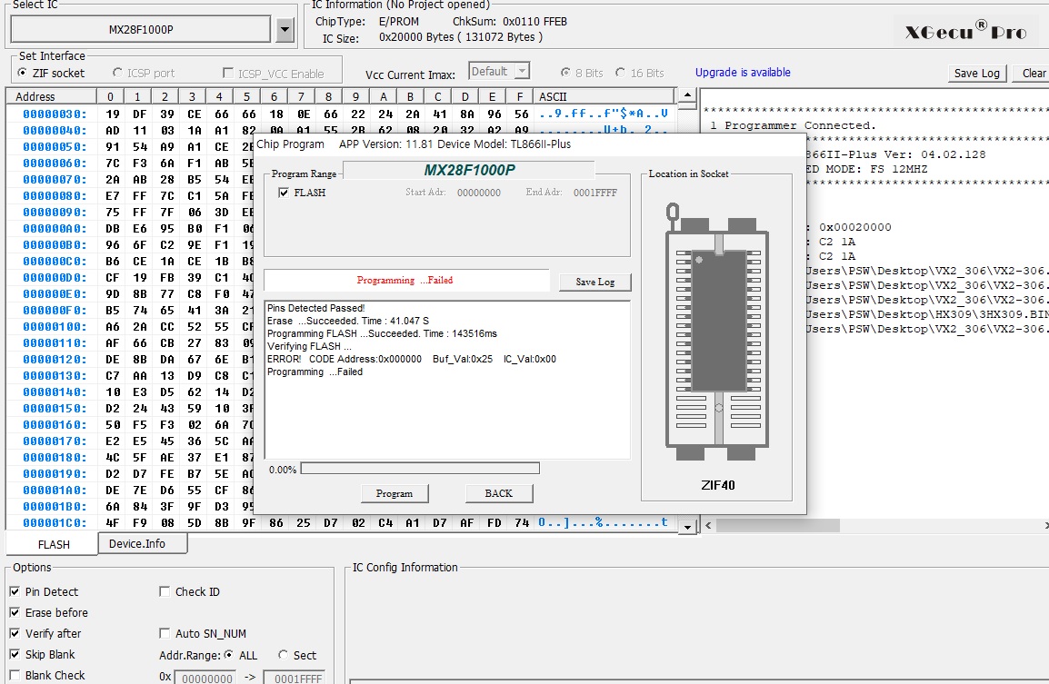

» [solved]mx28f1000p programming failed plz help me!
beckham7
782
2022-3-12
2022-3-16
beckham7
发表于 2022-3-12 00:16
(288.27 KB)
2022-3-12 00:15
my chip was bad. programming has done well

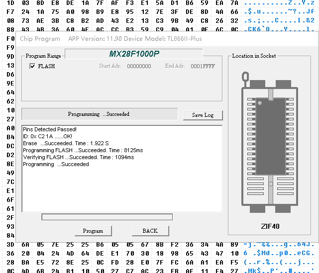

发表于 2022-3-12 14:06
beckham7 发表于 2022-3-12 00:16
As an user...It looks that you are running 11.81 version of Xgpro app. Have you tried to upgrade to 11.90 ? Sometimes, bugs are corrected even for already supported ICs...
Download Newest XGecu T56/TL866II software(下载最新软件) - 编程器使用与软件下载 - XGecu Programmer Forums - Powered by Discuz!
Hope it helps, or not :-(

发表于 2022-3-13 10:31
beckham7
Bad pins connect? or bad chip.
why you disable <Check ID>?
