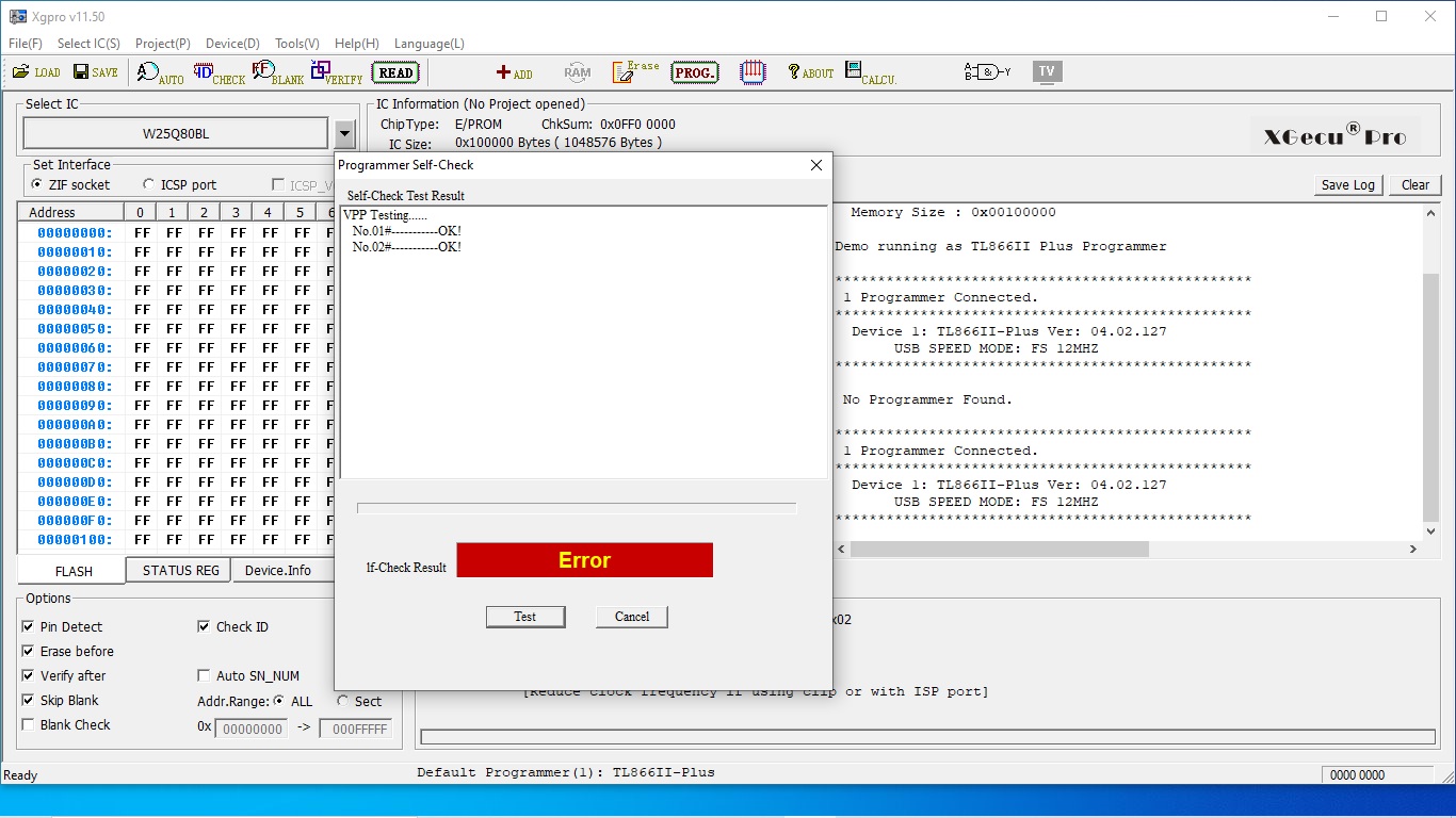

TL866 II Plus Self Check Error.
Please help me . I have TL866 II Plus programmer Self Check Not Working.
TL866 II Self Check ERROR[/url]
[url=
[/url]
(267.31 KB)
下载次数:12546
2021-10-19 01:43
发表于 2021-10-19 10:31
profesor
VPP硬件故障,只能返回维修
