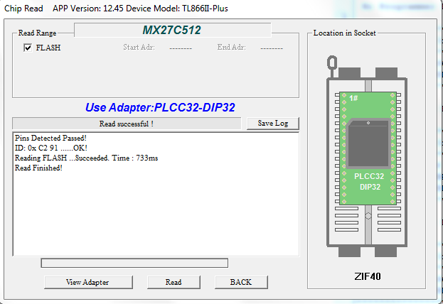

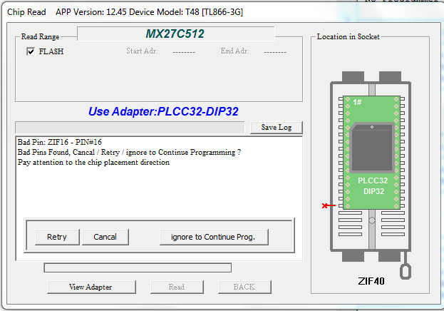

Hello, I tried to prog
ram
the
27C512
. I got an error message that
pin
16 was bad. So I tried the
TL866
II
Plus
programmer and it worked without any
problems
Is this a software error because the
T48
self-
test
is true with no errors?
(33.41 KB)
T48
2022-12-24 21:42
(34.05 KB)
TL866II
Plus
2022-12-24 21:42

发表于 2022-12-25 09:35
gmxspooker
this Pin is a Vss PIN. TL866 do not detect it.
VSS pin of few IC can not be detected. only ignore it.fix it in next version.
