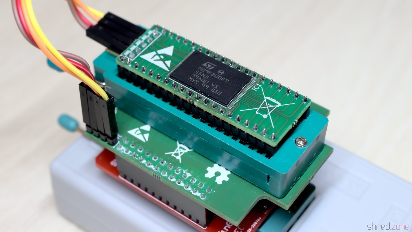

Hi, thanks for the reply. I have a couple of these devices and some use the 29F400 tsop48 chips and ...
scrappysphinx 发表于 2022-11-21 01:54
Hello, As the TsopXX ICs are programed as is, using any programmer will need an external adapter similar the
one you show for TL866IIPro, to 'reverse' the pin order to the 'native' IC. Most programmers are pin to pin, then using
T48 or using T56, the adapter should be simple to make as T56 have already 48 pin socket as no extension cable to the extra pins,
41,42....connect to the programmer front header. For a reference only, you have a page
T48 Adapter DIY (T48编程器自制适配器) - 编程器使用与软件下载 - XGecu Programmer Forums - Powered by Discuz!
were some DIY adapters are already present, maibe yours one day is there for other users enjoy.
Anyway, maybe ADMIN, or other user, helps with 'miracle' entries for the 29F800FT and 29F400, four and five pin headers, in
the XGECU software, to address it natively those boards, direct in programmer socket (if possible), plus info were to connect the cables to front end.
Hope it helps , sorry if no :-) |
