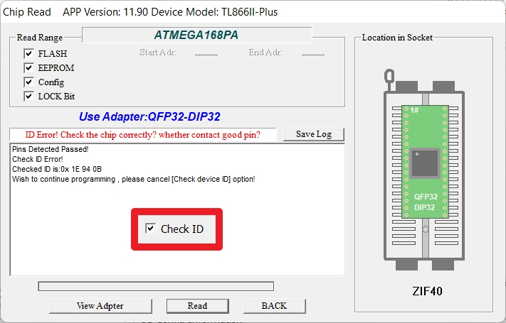

Hello. I have a problem. When programming ATmega168P and 168PA, it is not possible to pass the ID check. The program incorrectly specified the ID for these chips. Check the ID in the program for these microcontrollers.
Programming Atmega168 and 168A is correct.

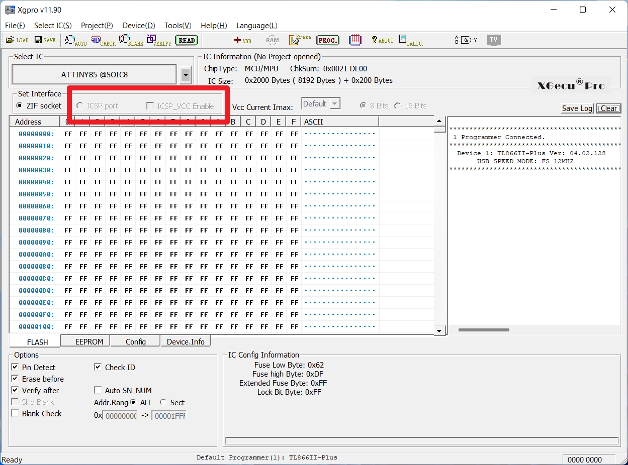

Add to the program the ability to program ATtiny25/45/85 microcontrollers via ICSP. Thank you.

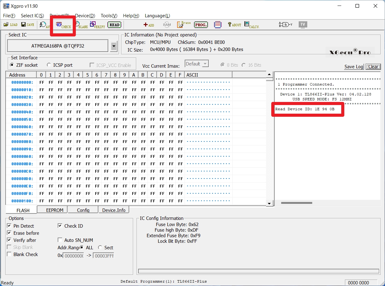

   As an user:                    Please, post the ID you are seeing in the log window (two bytes).
APP Version : 11.90   Model : TL866II Plus
Device : ATMEGA168PA @TQFP32
Read Device ID: 1E 94 0B

    Now i hope Admin say something, or correct the info for all, or whatever needed.With the ID, Admin usually comment  about it, sometimes equivalent IC rebadged,
new batch from newer manufacturer, bug, etc...hopefully
Thank You!

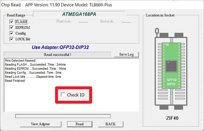

回复 4# Albano.Matos
   This is an error in the software ID entry, the ID will be fixed in the next version.   Disable ID checking, no effect on programming.
回复  Albano.Matos
This is an error in the software ID entry, the ID will be fixed in the n ...
admin 发表于 2022-4-11 15:20
Thank you.
Is it possible to add support ICSP for ATtiny25/45/85?
