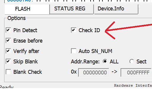

I have t48 XGECU pro i´m using the xgpro v12.66 however i get check id error when I tried to read the TSOP48 nand. MT29F16G08CBACA.
Can you please send me the correct software version?

    Hello as a user,                          Post here the Id's you got, please!, for some reasons
ID maybe different, or an image of it.
Anyway you can try remove 'check ID' selection, on lower left corner of app.Version 12.66 is the latest version available,
until a new one is released, please wait for announcement of it, the latest one take a few months :'( .
