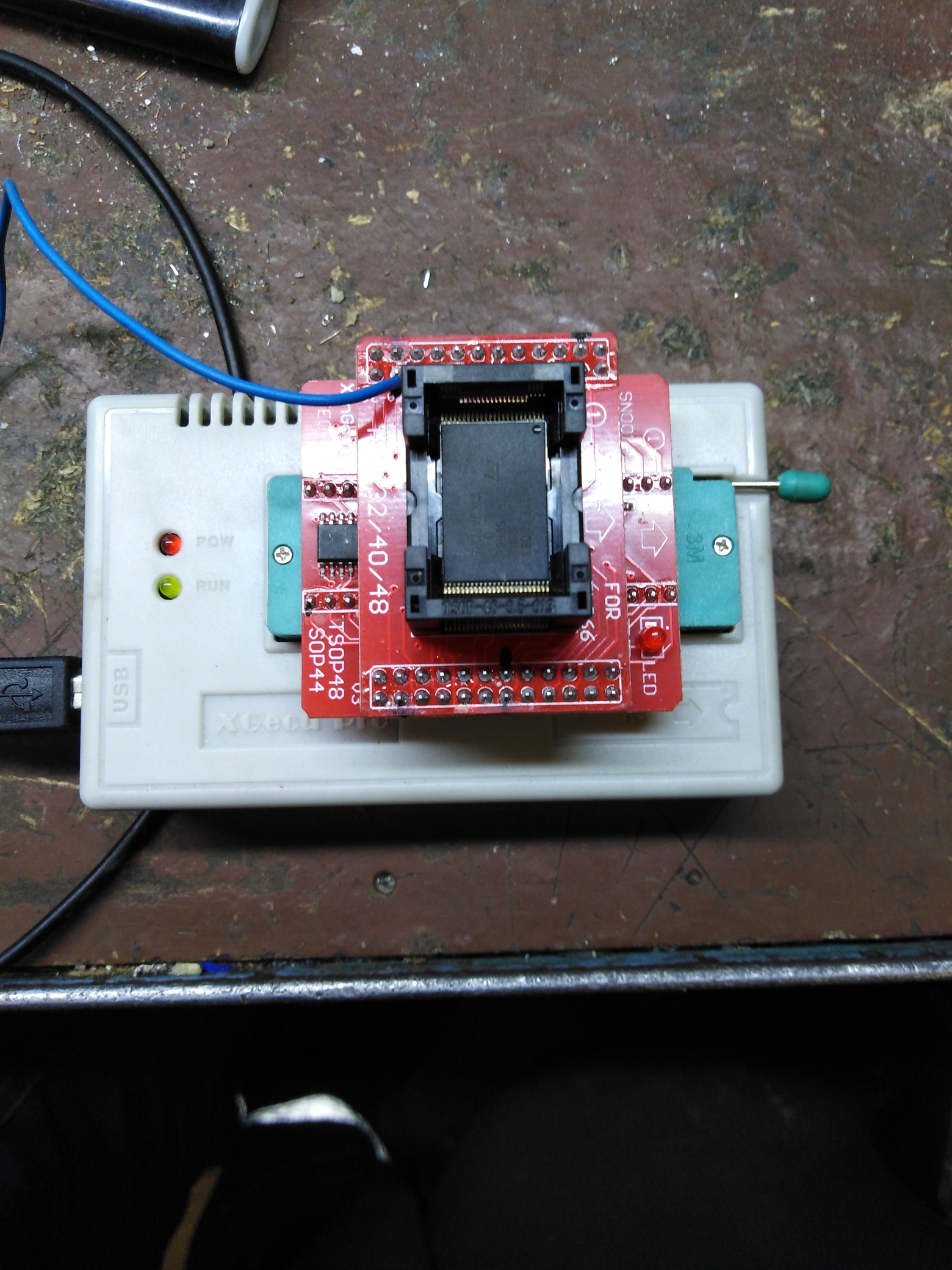

tl866 m29f400 adp sn001 problem
APP Version : 12.63   Model : TL866II Plus
Device : AM29F400BB  @TSOP48Pins Detected Passed!
Erase  ...Succeeded. Time : 0.031
SProgramming FLASH ...ERROR!
Address:0x00012C   Buffer Data:0x3000   Verify:0xFFFFProgramming  ...Failed
回复 1# ddeemmoo
换V12.55试试吧,我也是用V12.63,烧录总是失败,后改回V12.55,烧录成功了。
是的,我也是这种情况,换回12.55就好了。
