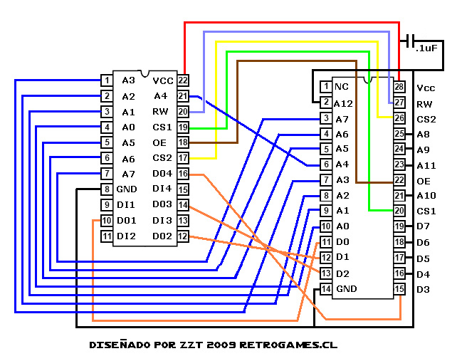

It can be replaced by a 6264 memory, so should be easy to add.
