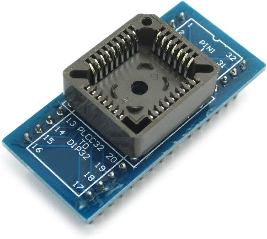

I have the TL866II plus and the T48, 2 PLCC32 to DIP32 adapters, I can't program any of my brand new devices AM27C010,  AM29F010B or SST39SF010A, the programmers sometimes write part of the devices but most commonly error is at address 800, I already damaged many 27c010 because they are one time programmable, I tried 4 different computers, windows xp, 10 or 11, 32 or 64 bits, why I'm having issues if they are in the supported list? I bought the devices from the distributors, no clones. Please help.

Here is the adapter I purchased and I don't recommend:
The PLCC socket is too near the DIP pins and shorted. Junk.

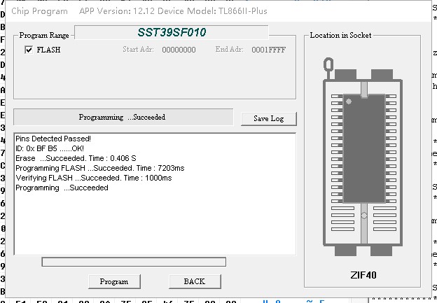

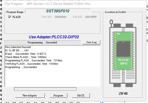

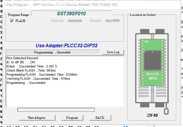

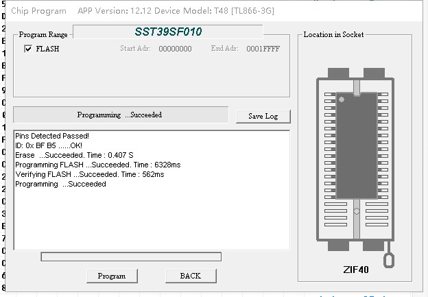

Also tested SST39SF010A, working good, PLCC32 to DIP32 adapter fixed.

Problem solved with AM29F010B, problem was the adapter, it was shorting some pins from the PLCC32 socket to the DIP32 pins, too near.
