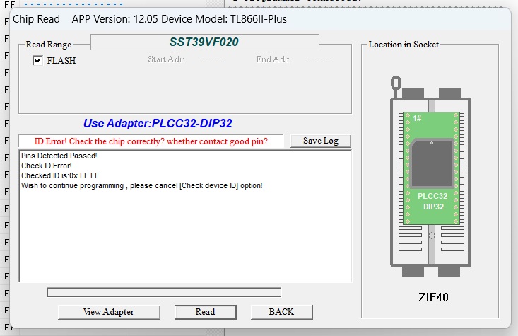

I have successfully read several PLCC32 (SST39VF020) and now try to program the .bin files to brand new and empty
EEPROMs (also SST39VF020). This always fails with the following error:
APP Version : 12.05   Model : TL866II Plus
     Device : SST39VF020 @PLCC32
Pins Detected Passed!
Erase  ...Succeeded. Time : 0.391 S
Programming FLASH ...
ERROR!  Address:0x000000   Buffer Data:0xA0   Verify:0xFF
Programming  ...Failed
I tried 9 different EEPROMs and several different .bín files but it is not possible to progam any. Please help

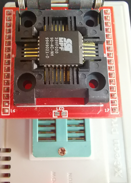

I tried 2 different programmers and two different PLCC32 to DIP32 adapters. I am starting to thing the adapters are no good.

As I said, 6 chips are brand new and none of them works. I also cannot identify an issue with the socket. For PLCC32, I would need to check which pins are used for writing the Address: 0x000000 . Could there be a short in the socket?

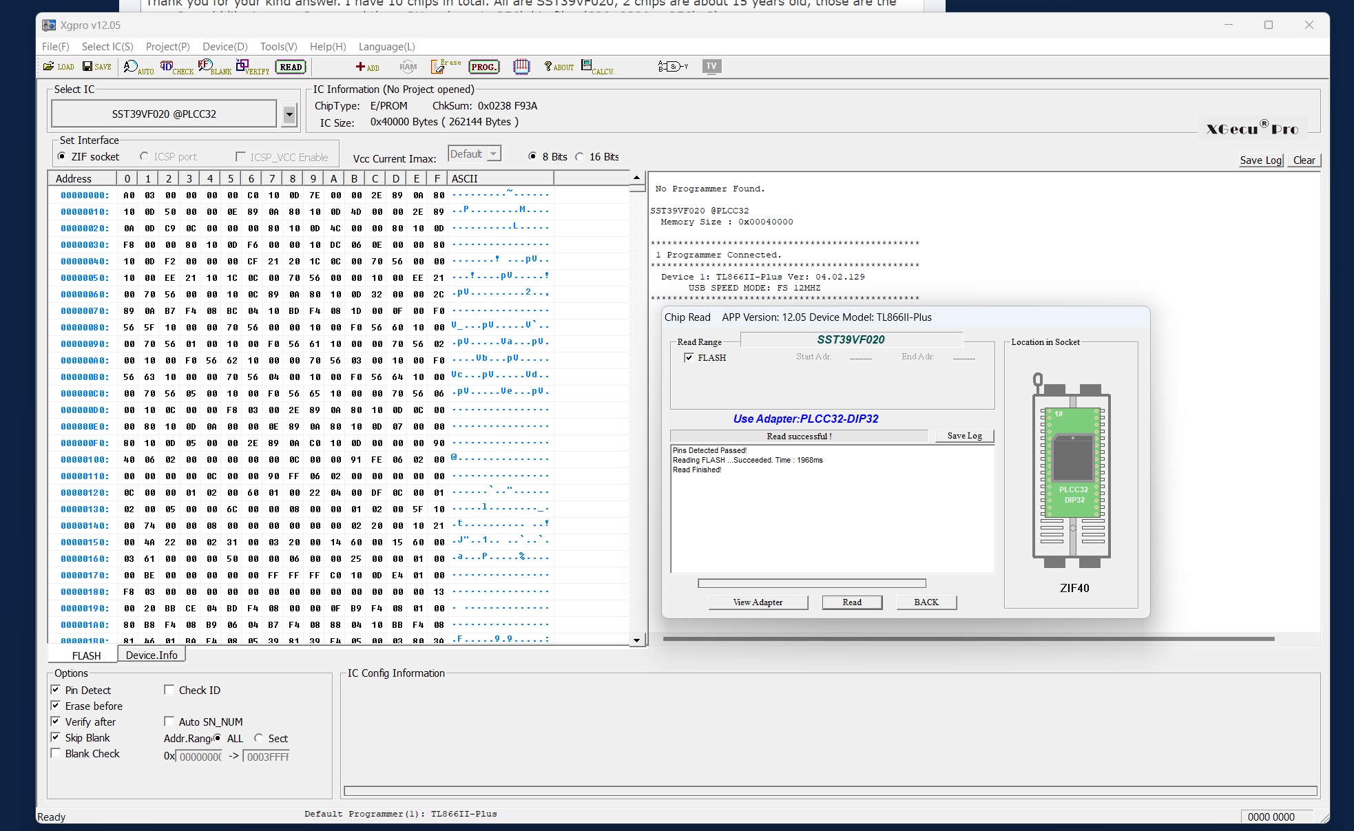

Thank you for your kind answer. I have 10 chips in total. All are SST39VF020, 2 chips are about 15 years old, those are the ones I would like to copy. I can read them OK and create 256k bin files (020, 020A = 256kx8)

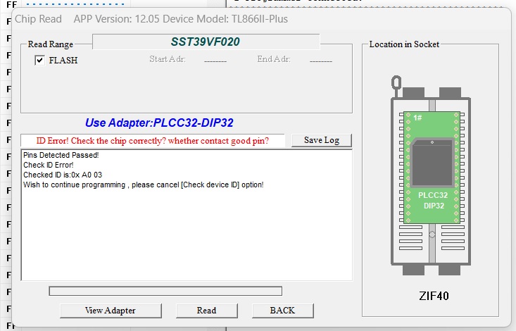

I do have to turn "Check ID" off, as it always fails for any PLCC chip.
Here reading the old master chip with Check ID ON
Here the new chip with Check ID ON
Here the master chip with Check ID OFF... it reads the data

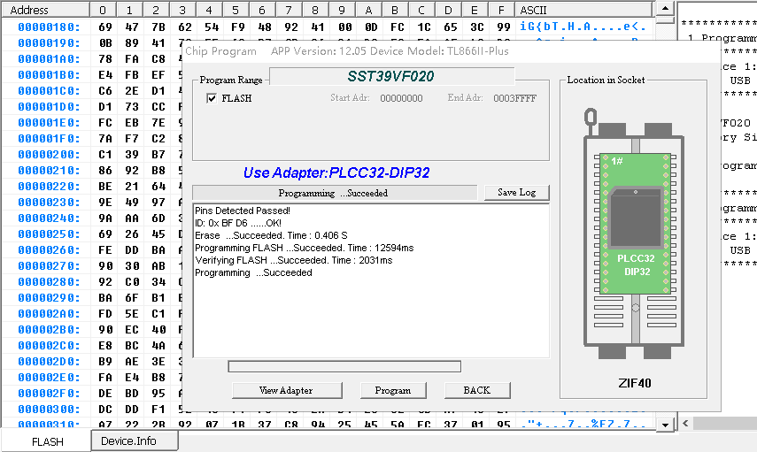

why disable CHECK ID?
these chips maybe too old.
i found this model of chips are often broken, and the ID cannot be read. Generally, it is a bad chip.
I tested it . everything  is normal.
