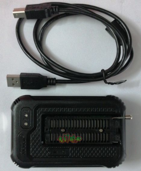

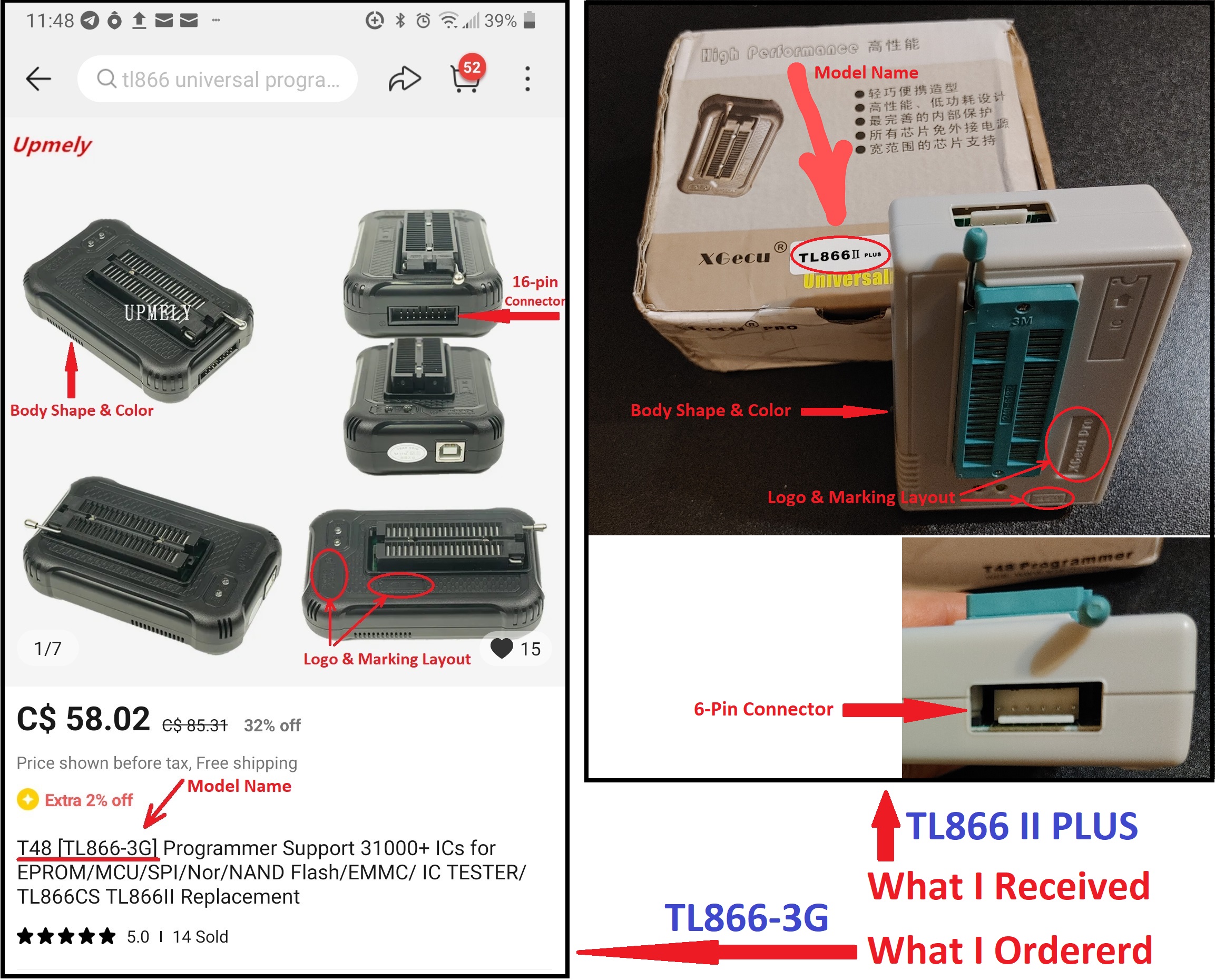

回复 55# Shahram-K
   The picture on the right is not T48
Please someone kindly help me:
I ordered a T48 [TL866-3G] from a seller via Ali-Express, But what I finally received, Had been Labeled as TL866 II PLUS and the device has a complete different body shape, Body Color, Logo & marking layout, and Connector .
Please kindly tell me if I received the correct "3rd Generation" or they have sent me a wrong item.
Thank you so much, with kind Regards

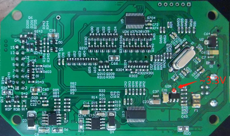

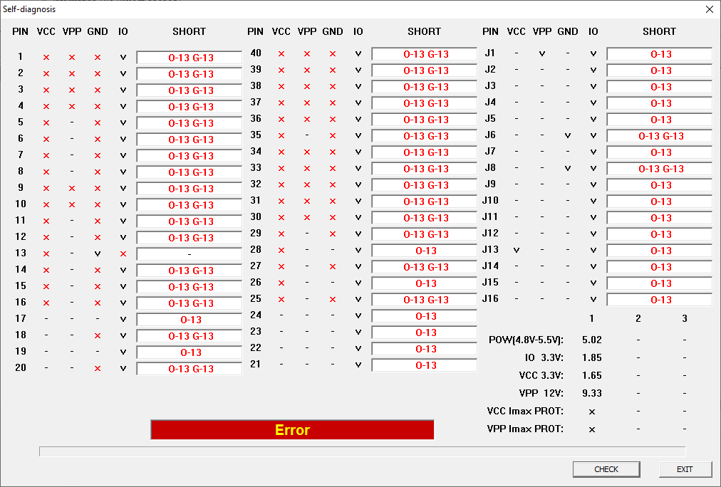

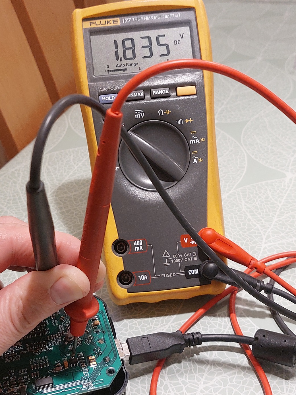

Thank You for quick response and proffessional support.Yes, voltage is 1.8V instead 3.3V.
I will order LDO.
回复 52# Requan
Sorry .it was broken.
open the box . Test the voltage as picture.
it 's normal about 3.25-3.35(3.3V), otherwise , Please replace the LDO  AMS1117-adj (Package:SOT89) .
Dears,I bought original T48, use the newest software and firmware, but it not working at all, video shown below, that it aren't able to write simple memory (24C32W):
https://files.fm/u/xk2xb7je5
I try to read and write the same memory with the same socket on my cheap programmer EPZ2019+ and it working without any problem.
Could You help me ?
self test failed

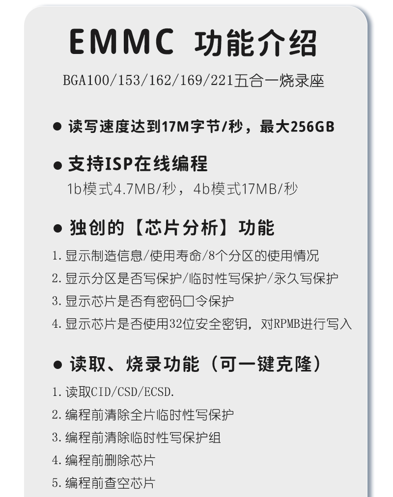

48 56脚座 EMMC座子子什么时候出货?
回复 33# bedz

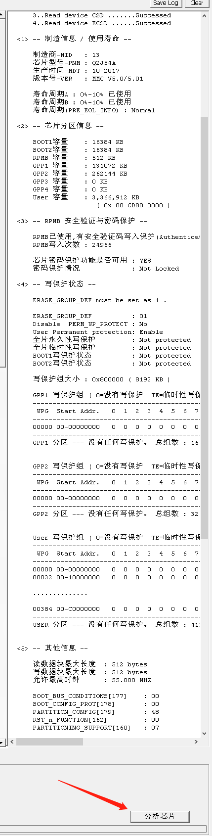

T48与T56相同,EMMC功能完整,功能上PK任一台EMMC编程器,是最完整功能的EMMC编程器之一。快速、稳定、可靠。并可以作工厂小批量生产使用。
编程器软件有一个好用的EMMC【分析芯片】的功能, 说明书里面有完整介绍。
能显示EMMC芯片完整信息,寿命只是EMMC5.0以上含有的一个最简单的参数。EMMC有很多很重要的参数
(想不通,为什么显示众多信息中的一个EMMC的简单参数,用户会说成了一个编程器的功能。那么100个参数就变成了100个功能)
分析芯片的结果如下:
T48是否支持EMMC使用寿命检测?

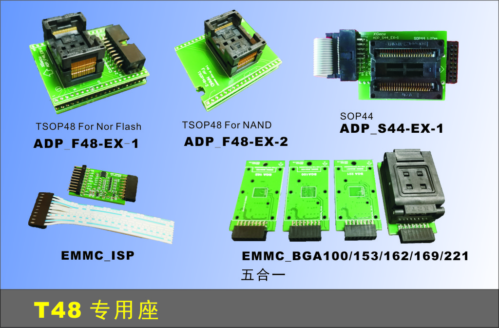

How much will it cost EMMC ISP driver? $10, $20? When will it be on sale EMMC ISP driver?
回复 25# Evcon
Yes ,all EMMC adaper and EMMC ISP driver have have an encrypted chip to identify the driver.
Features and Benefits:
1. All adapters are strictly tested by the original factory, and the quality is more guaranteed.
2. The price is also cheap.
3. All different BGA adapters have the same shape, and the software can quickly identify them to prevent wrong using.
4.EMMC ISP driver needs to deal with signal interference and voltage conversion, it cannot be used directly without ISP driver
回复 27# 梦翔科技
   6月底,最晚7月初,已经在生产线上
Is it possible to program eMMC in ISP mode without using eMMC_ISP driver?
Does the eMMC_ISP driver have an encrypted chip to identify the driver?
Do you think it's a good idea not to use universal adapters for TSOP48/SOP44 in the T48?
