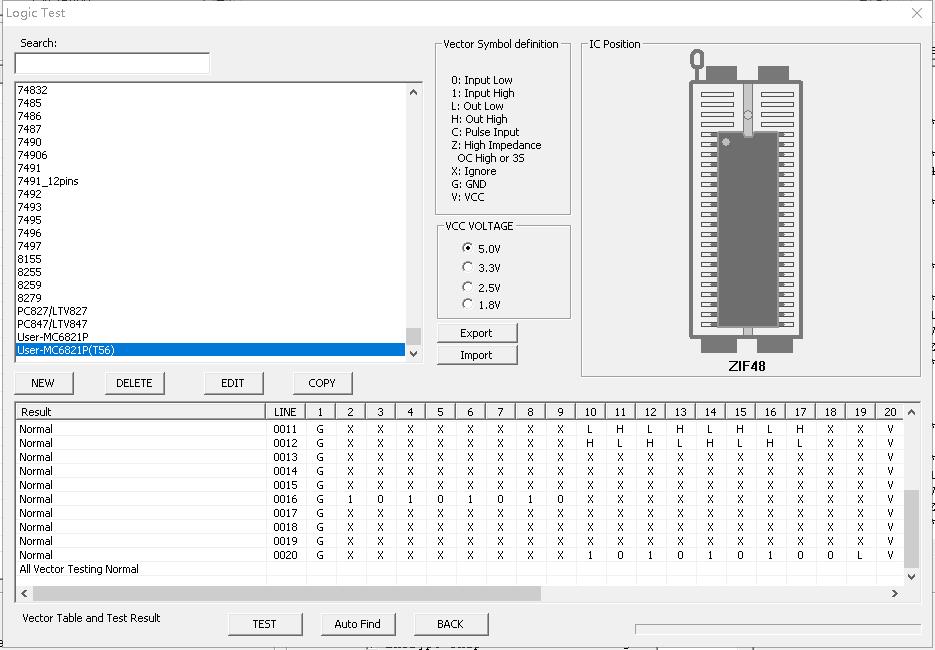

   T48 and T866II is not a VCC on PIN20 , so it only Tested on T56.

Sorry.Because T48 and T866II is not a VCC on PIN20 , so it only Tested on T56.
and it is a bug we will fix it.

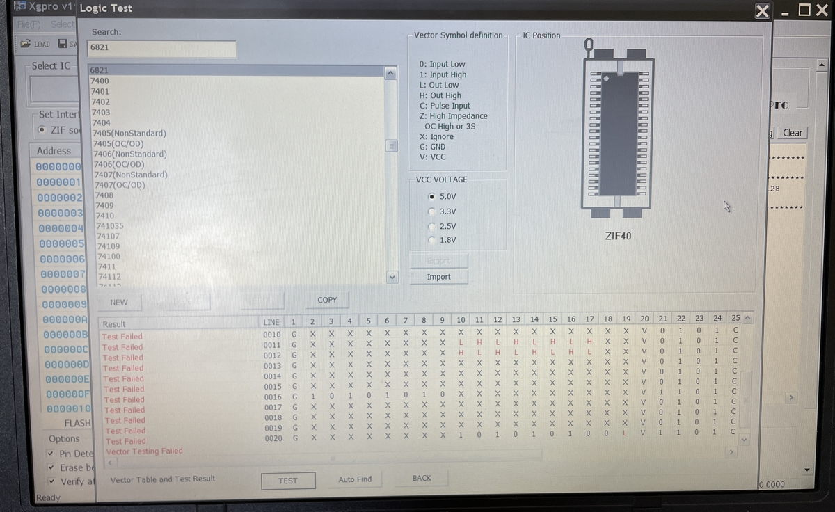

Tl866 II, T48, T56, Not support this MC6821Chip.Best regards

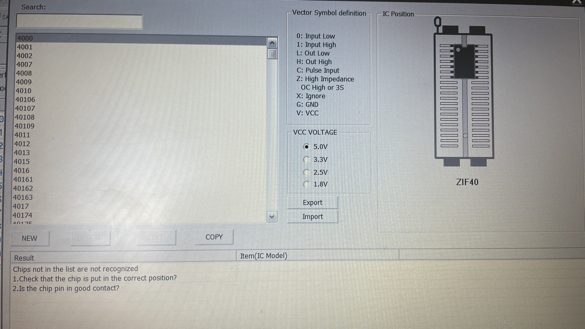

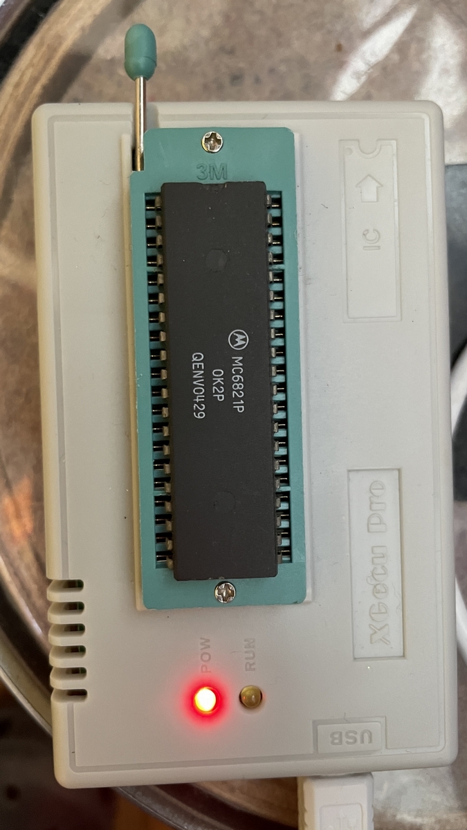

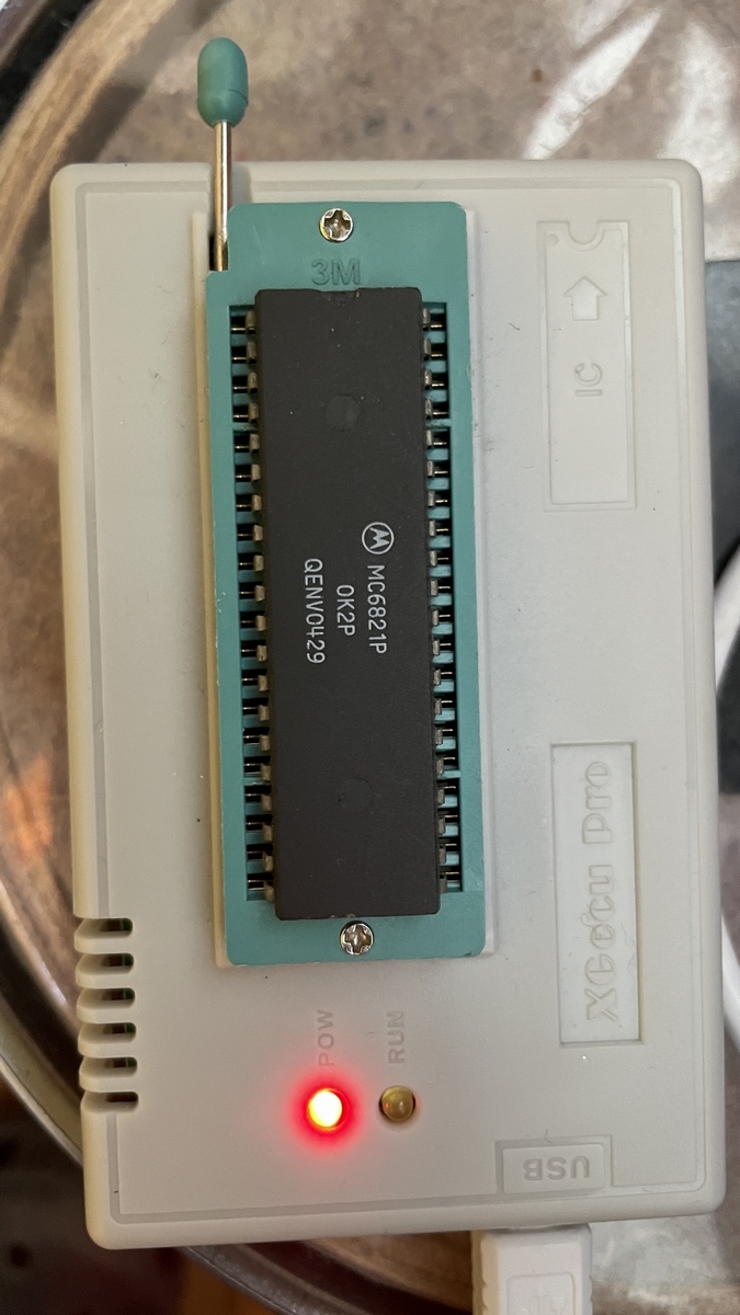

Hello, I have the same problem. I have tested more han 10 MC6821P chips and Autofind fails and Test fails by the TL866+.You can see here my 3 pictures attached.
Is there any specific setting to apply or something ?
MC6821P position.jpg (461.01 KB)
position

MC6821P test.jpg (579.85 KB)
Test result

              As an user....Can you, please, post an image of the error, or several images?
