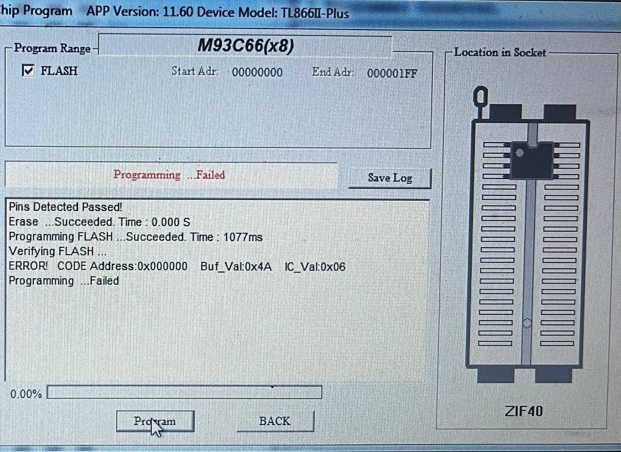

My member my ic 93c66 reading success but writting error please help

             As an user....you appear to be running version 11.60, that had a flaw verifying after programing with several ICs. I recommend to update to latest version, maybe your
IC have also been affected , but not sure.  11.71 is the latest.

Thx for ur answer admin. but I read and save as 8bits and now the file is broken so is it anyway to write as 8bits admin🙏
回复 1# lykimleng
   try choose 93C66 (X16) 16bits mode
