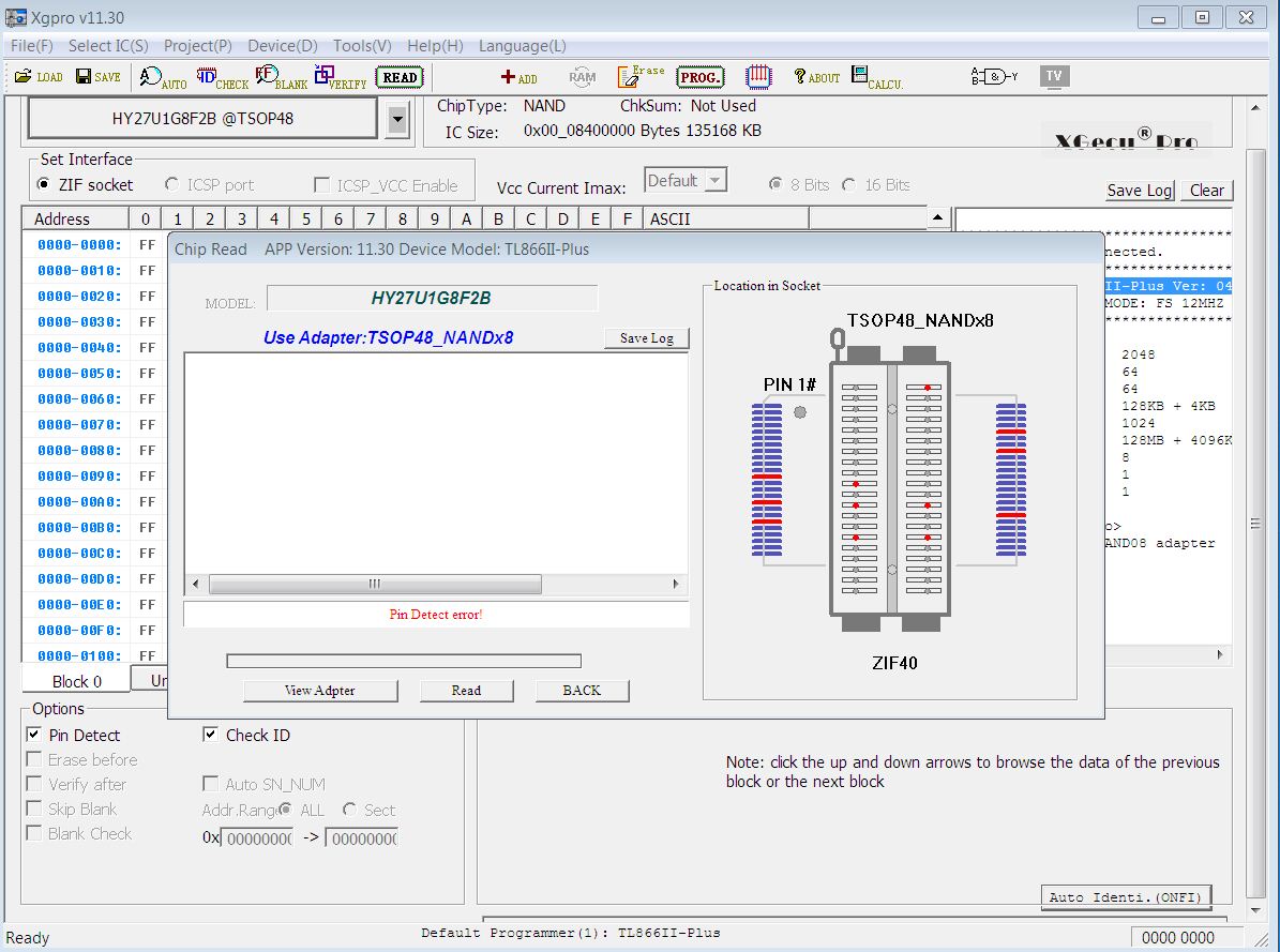

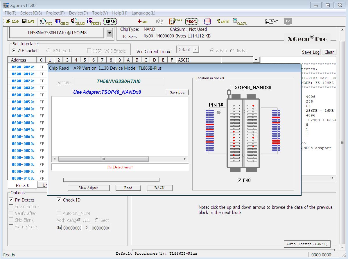

I am having constant pin error on any 48 pin chip, even new ones and good ones removed from a working TV, check adapter pins to IC with DMM and pass OK, did short test on adapter and passed too, I do not see this device send any power to the pin 12 and 13 in the toshiba TH58NVG3S0HTAI0 as this ones are the power pins, it just trow pin errors.

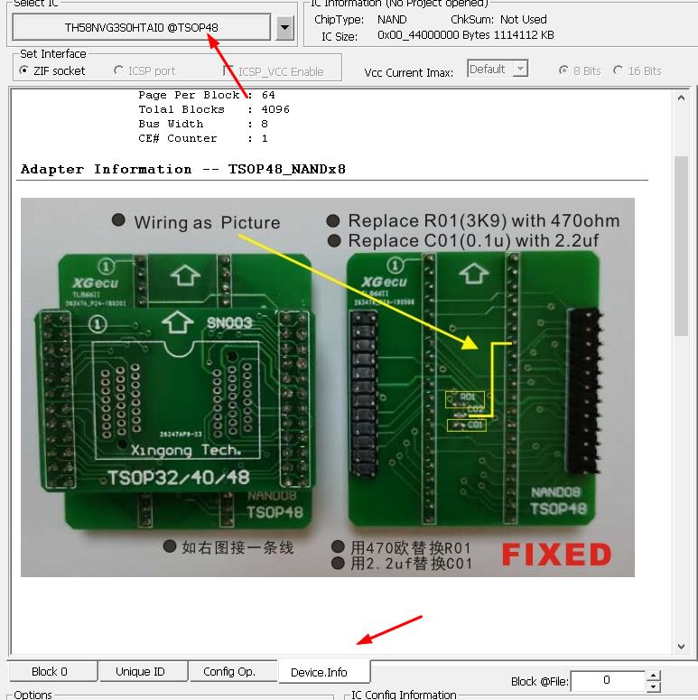

   Hello,            After select the correct IC to program, sometimes there are the same reference,
but different case, always do the way that Admin recommend.
As an example , selecting IC ... AC39LV088   and pressing 'device info', you will see the image
of adapter you already have. As most adapter have 2 stages, sometimes, the very same base
can be used with several top adapters. For TVs i prefer not shaping parts on critical parts, to
avoid bad contacts, and other damages, that's why i got V2.
Hope not confused you :-(

see <device Info>for correct adaper,
TL866 NAND use a specail adapter
Using this adapter.

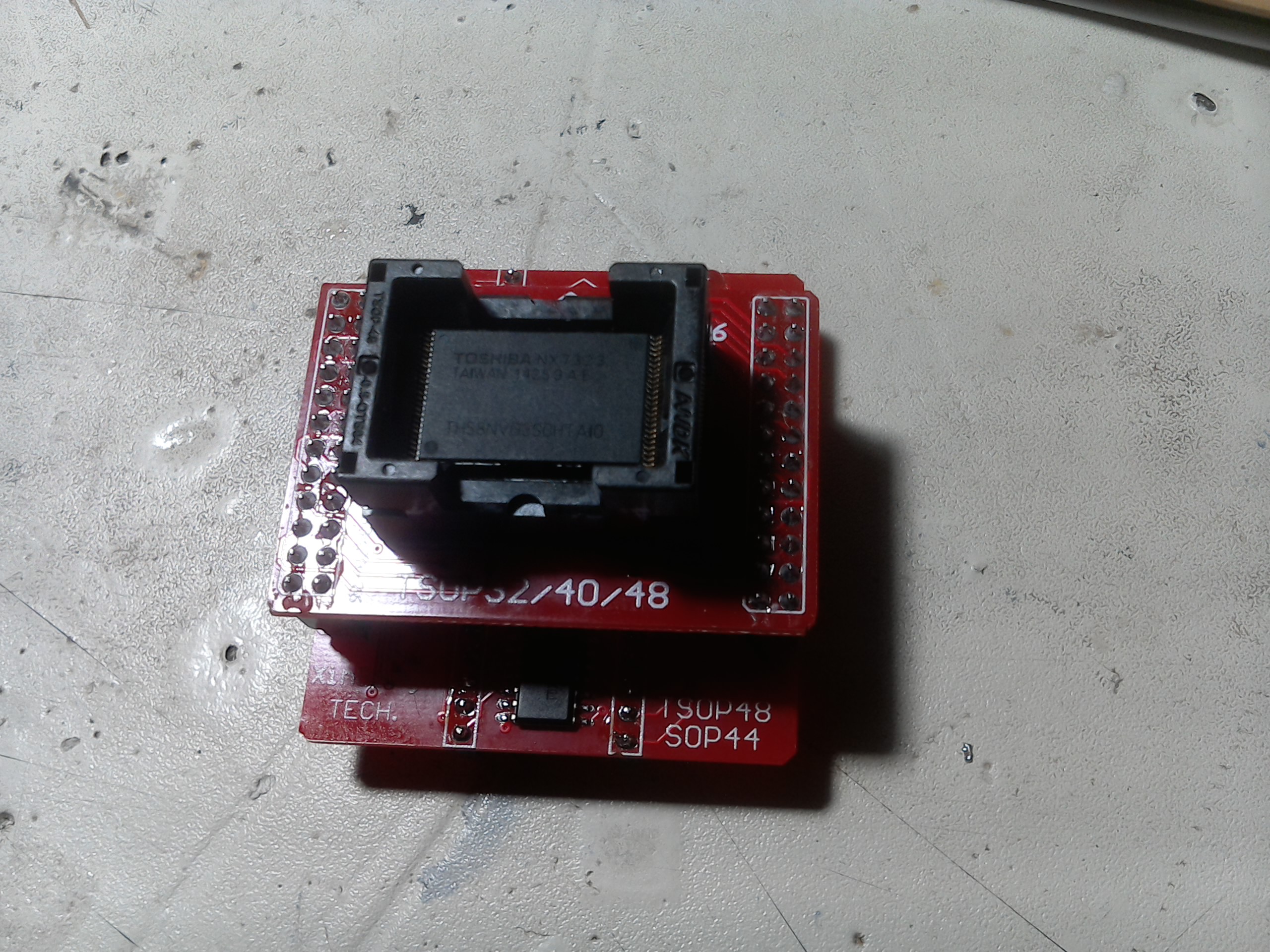

   Hello , I think , sorry if i'm wrong, the adapter you are using is for old models of TL866A-CS and not for TL866IIplus
I've ordered this one, link below,  and works ok , V2 the newer one, does not need modification (v1, does and is documented
in 10.30 software, if you press device info)
Android tsop48 nand nand08 adaptador/adaptador ic socket, somente para tl866ii plus programador para nand flash chips, mais novo v2 fixo|Calculadoras| - AliExpress
If you have bought a kit , maybe you find it already there ( bottom part )
Using this adapter.

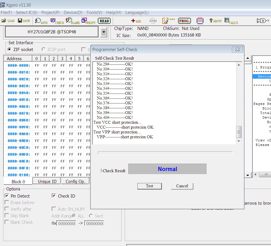

Error with a good working IC, just removed from a working TV

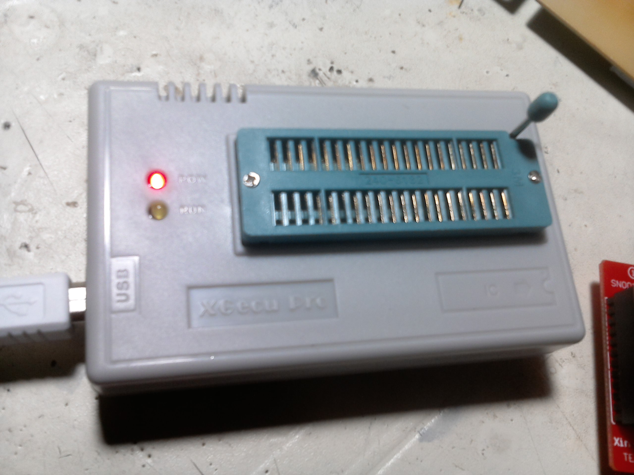

Self test is OK, this device only works for the 8 pin EPROM so far, unable to fix any TV with this device.
Error is on any 48 pin IC new or used
