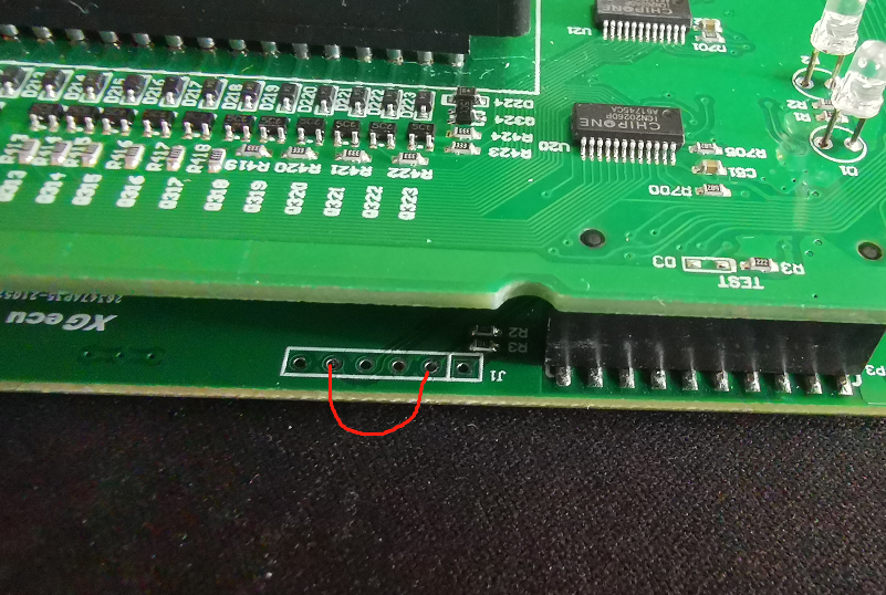

   Hello,            As a user.... As i know, jumpering pins as stated can recover the programmer from an incomplete flash,
as it will ( maybe) be recognized but not functional, and reflash option did not become available after Xgecu
software start, or if flash fail in early stages, and programmer isn't recognized at all, leds always on,
(if no hardware failure) it will be recognized and allow reflash to latest level within xgecu software.Normal Leds start sequence is 'Run' blinks a little and turn off, only 'power' stays on, starting xgecu software it will blink 'Run' briefly,

Hi. I'm from Poland. A few days ago on Aliexpres I bought a new XGecu T56 programmer. I have a problem with him. The programmer is not recognized in any computer.
The latest software is properly installed.
I tested on different USB cables and on different computers with different operating systems.
After connecting to the computer, both LEDs (power and run) are on continuously. I didn't connect to the computer even once, I didn't do "Reflash firmware", because there was no such possibility. I'd rather save the hassle of returning to the store. Please help, is it possible to damage the programmer or rather the firmware?
I saw on the forum a description of how to go to BOOT mode by shorting J1 PIN2 and PIN5. Therefore, I have a question, where is the re-uploaded software? Thank you.

回复 4# CrisELDi
Disassemble the programmer and connect the ports PIN2 and PIN5 of J1 connector.
Power on the programmer, it will enter BOOT.if it is normal . reflash firmware.
then diconnect pin2 and pin5 of J1
