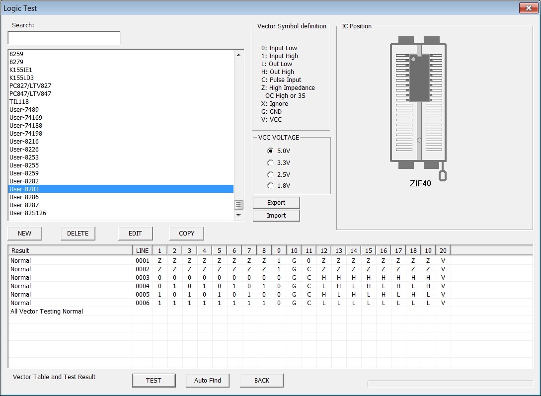

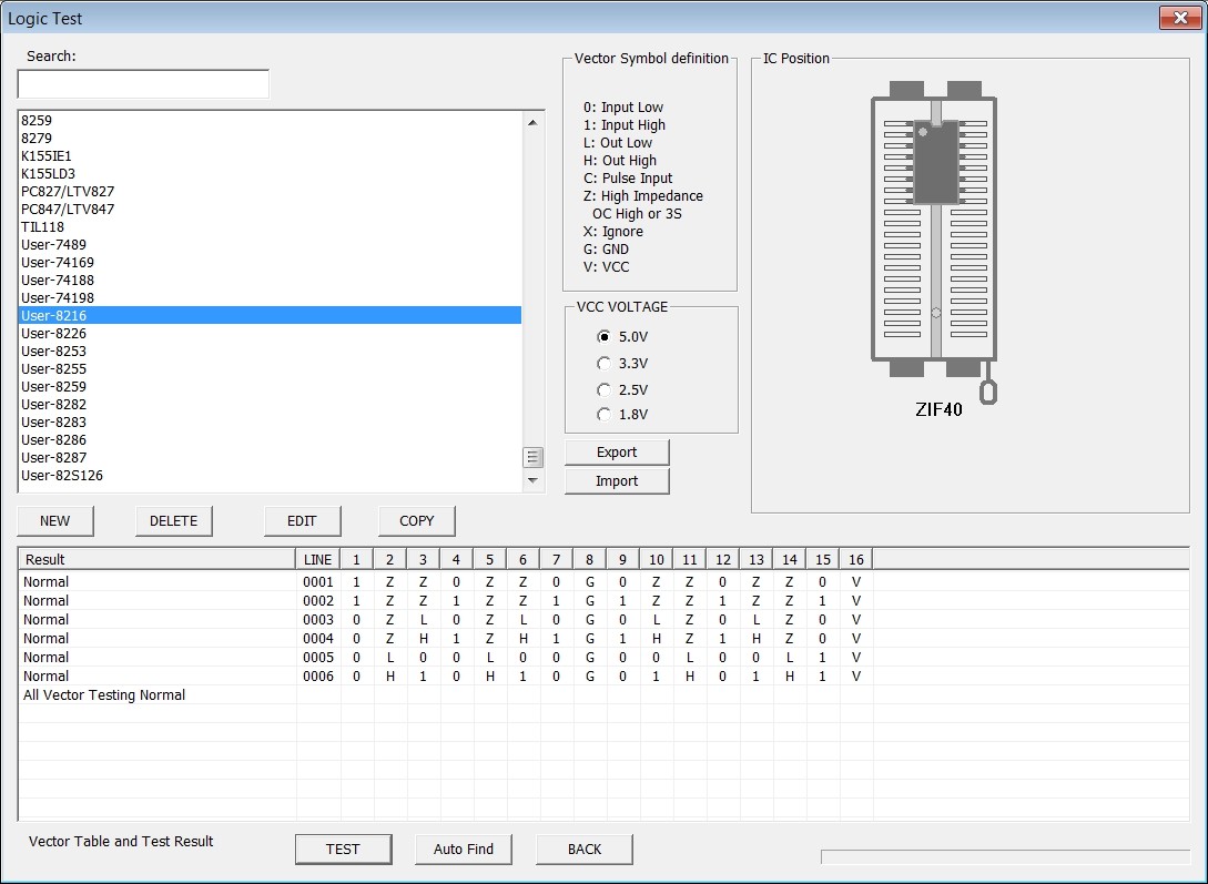

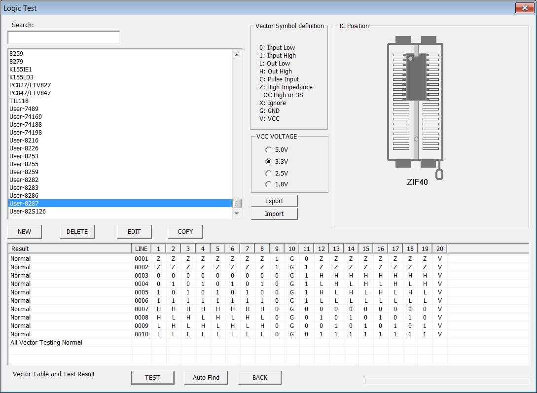

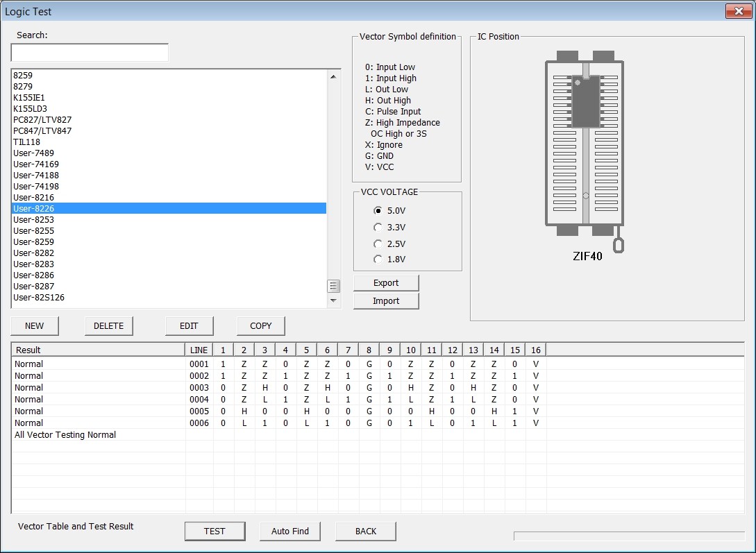

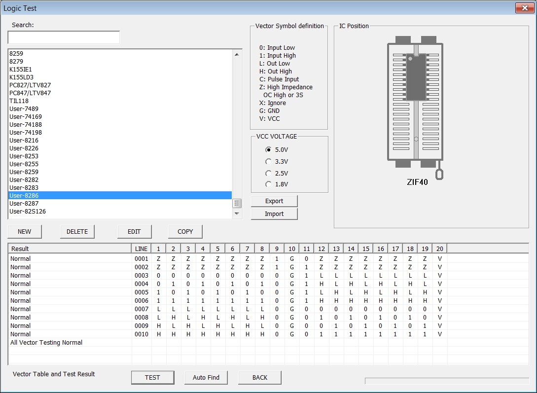

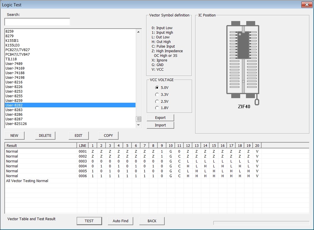

发表于 2026-8-30 16:50
(124.85 KB)
2026-8-30 16:48
(124.89 KB)
2026-8-30 16:48
(130.41 KB)
2026-8-30 16:48
(130.38 KB)
2026-8-30 16:48
(143.36 KB)
2026-8-30 16:49
(143.44 KB)
2026-8-30 16:49
