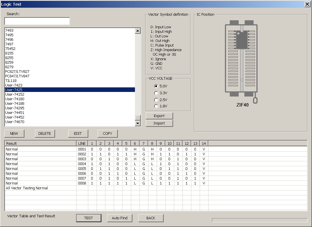

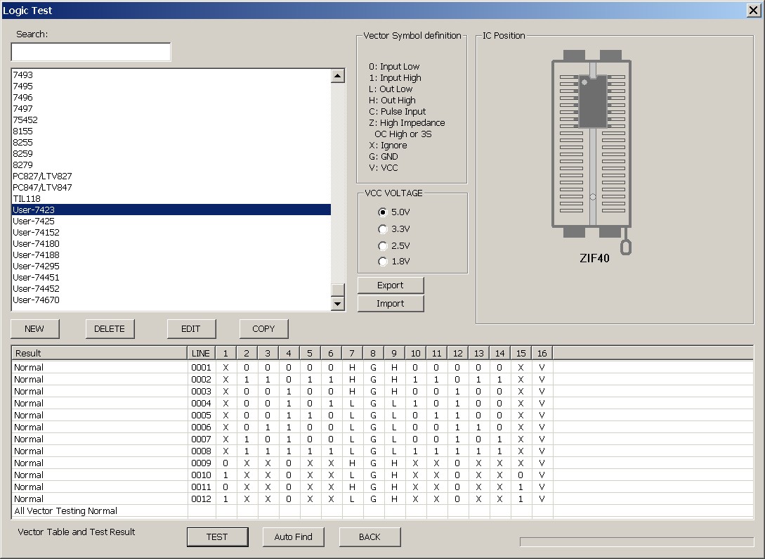

7423 (16 pin), 7425 (14 pin)

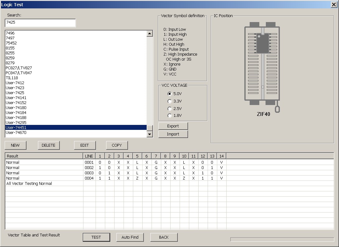

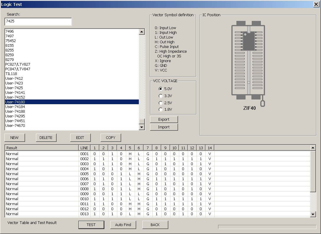

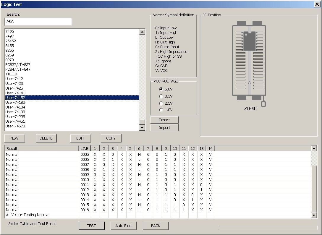

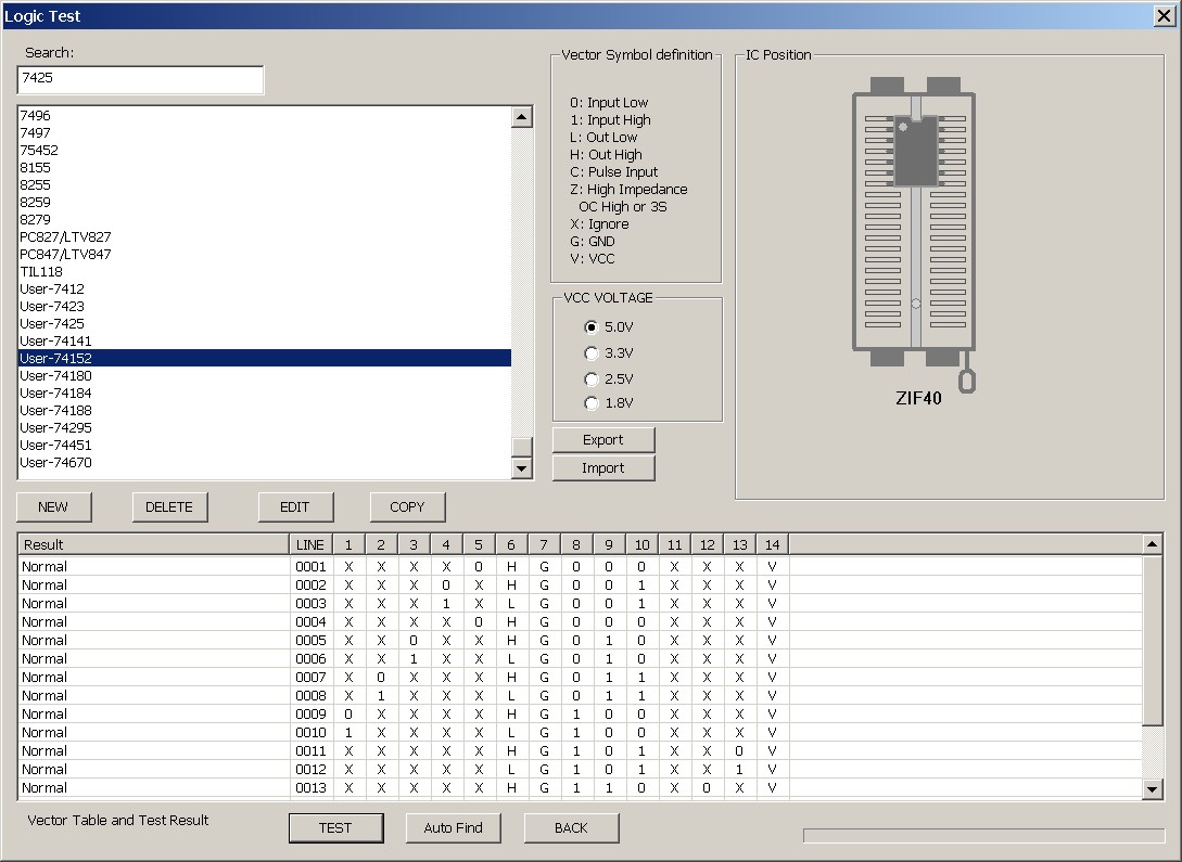

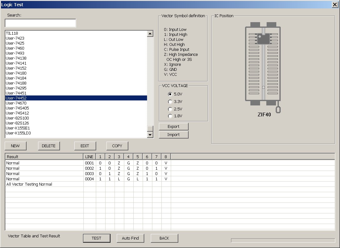

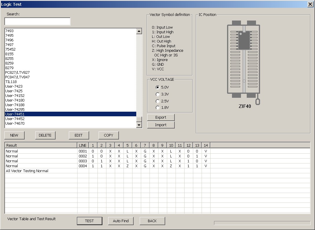

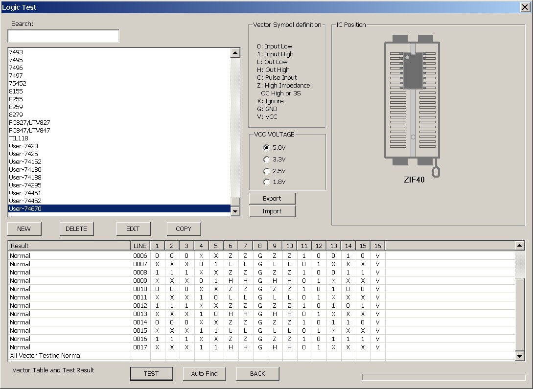

74152, 74180, 74188, 74295, 74451, 74452, 74670, 82S126

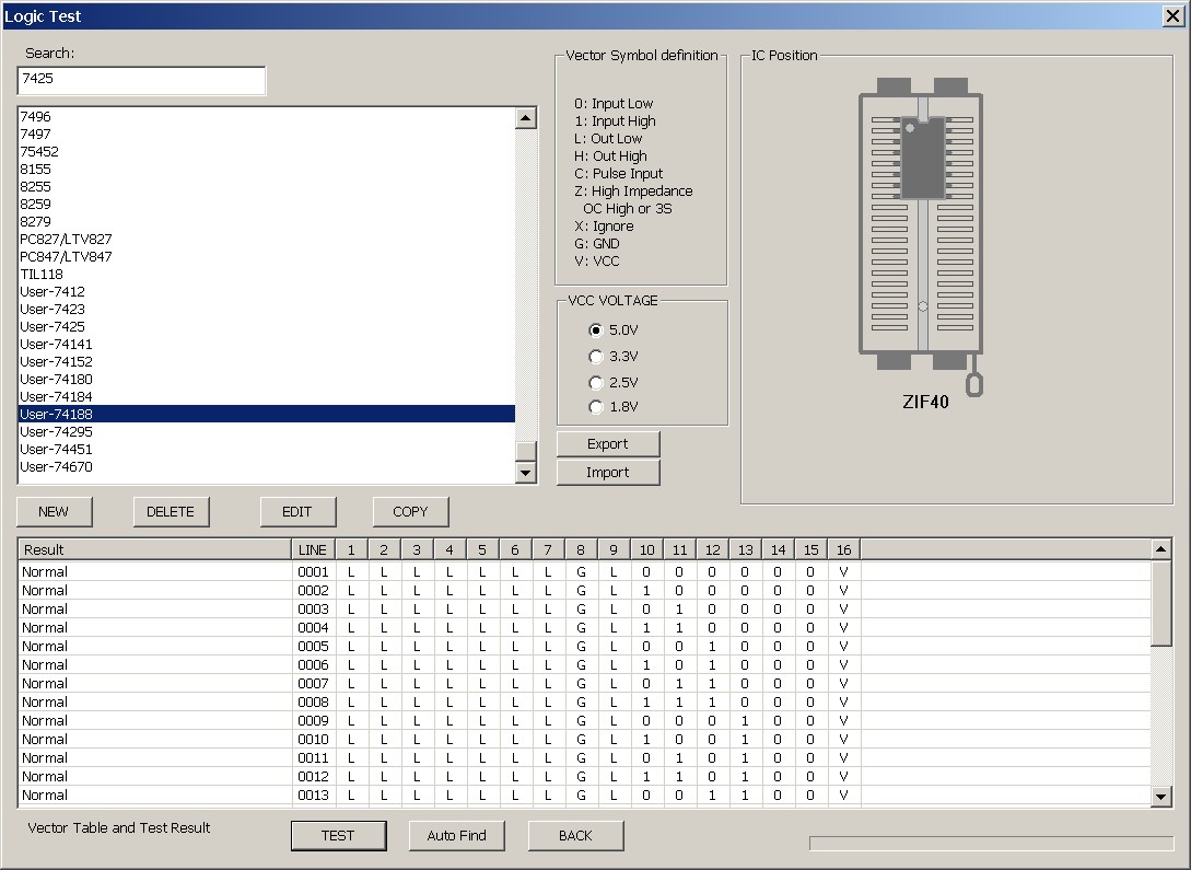

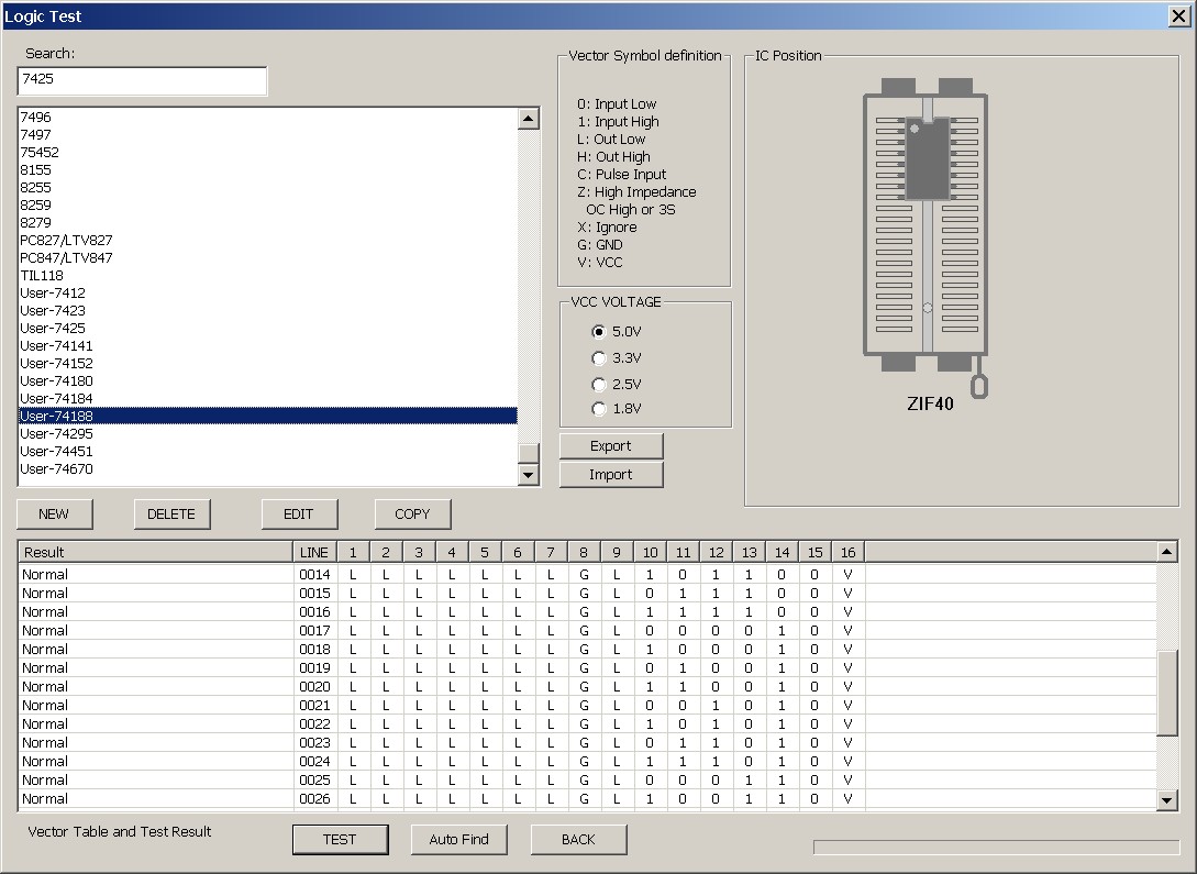

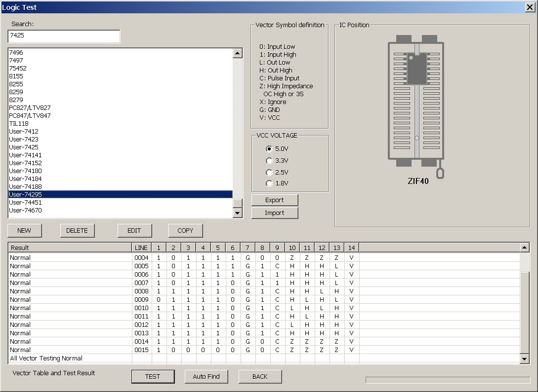

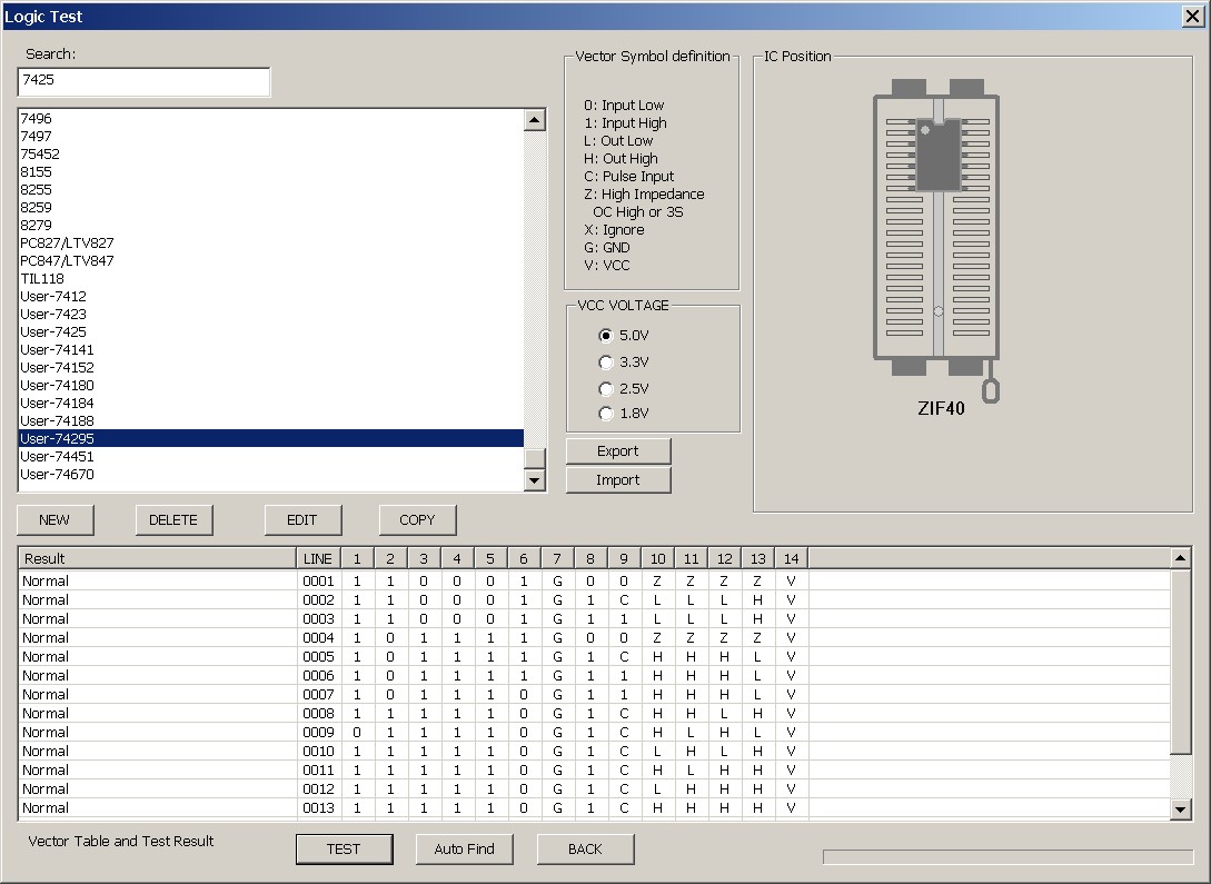

74188 empty or programmed?
Igor 发表于 2024-4-15 11:33
Only empty
