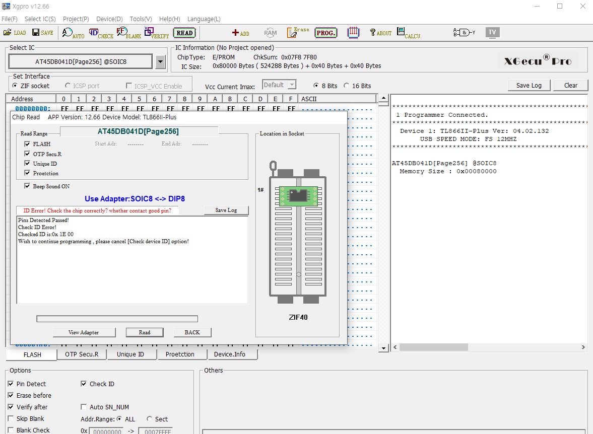

adesto 45DB041D SOIC8

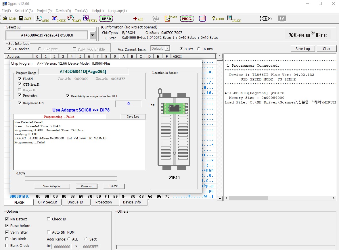

Programming is not possible.
There is an ID error.
Please check.

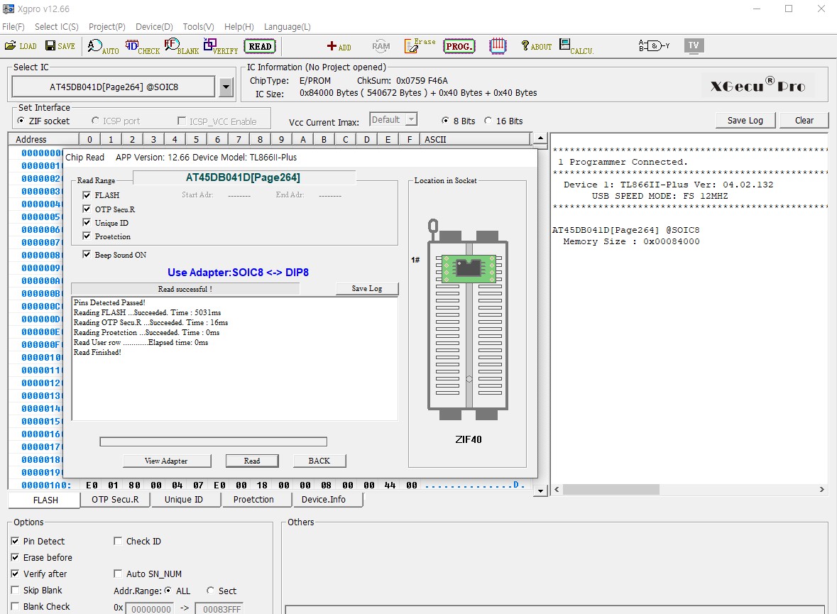

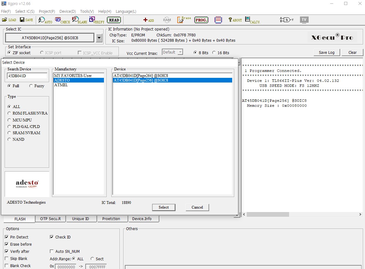

         As a user... There are 2x 45DB041D in the selection, verify.
You can always 'uncheck' CheckID , bottom left in the Options of Xgpro App.
Post image or copy text and put here what IDs appear,
maybe ADMIN need to correct, or add new version :)
