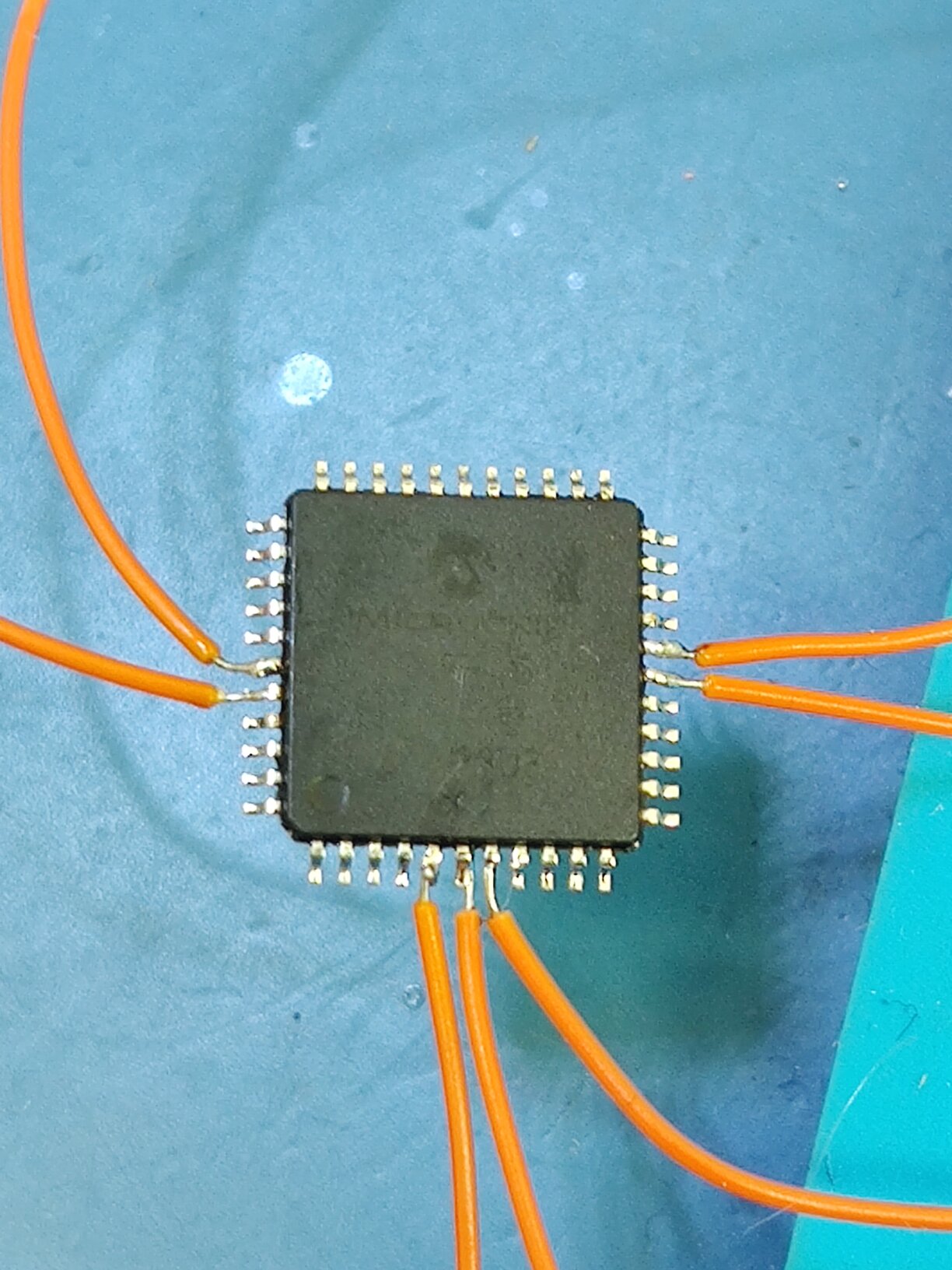

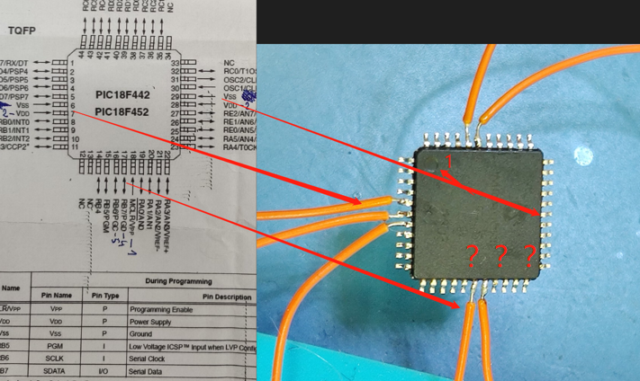

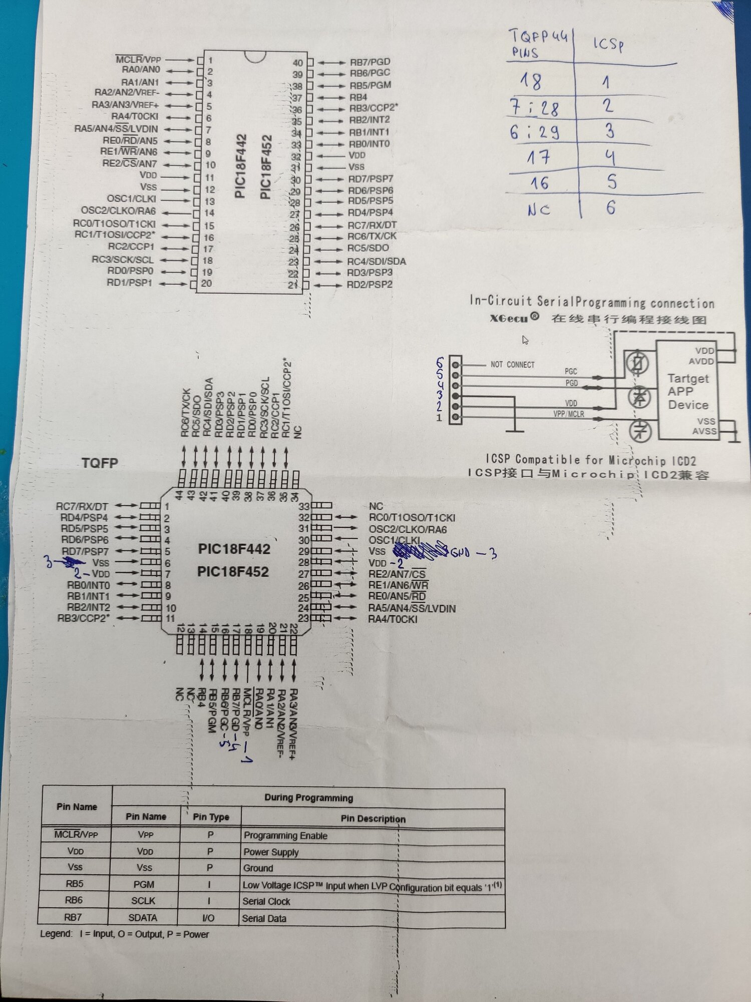

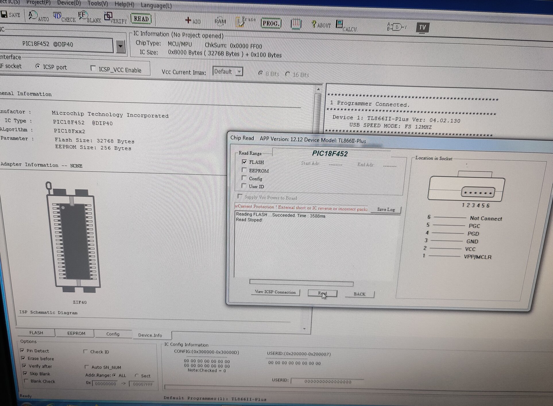

Hi, i buy original TL866II plus with almost all adapters from you. I have problem that i cant read PIC18F452-i/pt.I select microchip pic18f452 (dip40) in program and select ICSP port (ICSP_VCC Enable) and soldered wires to same chip but in TQFP package. And try to read it but it start to read it and when it almost finish reading it give me error: overcurrent protection! external short or IV reversed... Can you please help me how to connect and read that chip please, if i did somening wrong. rsz_img_20230527_140210.jpg

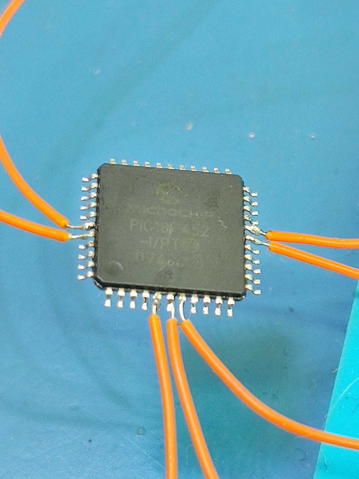

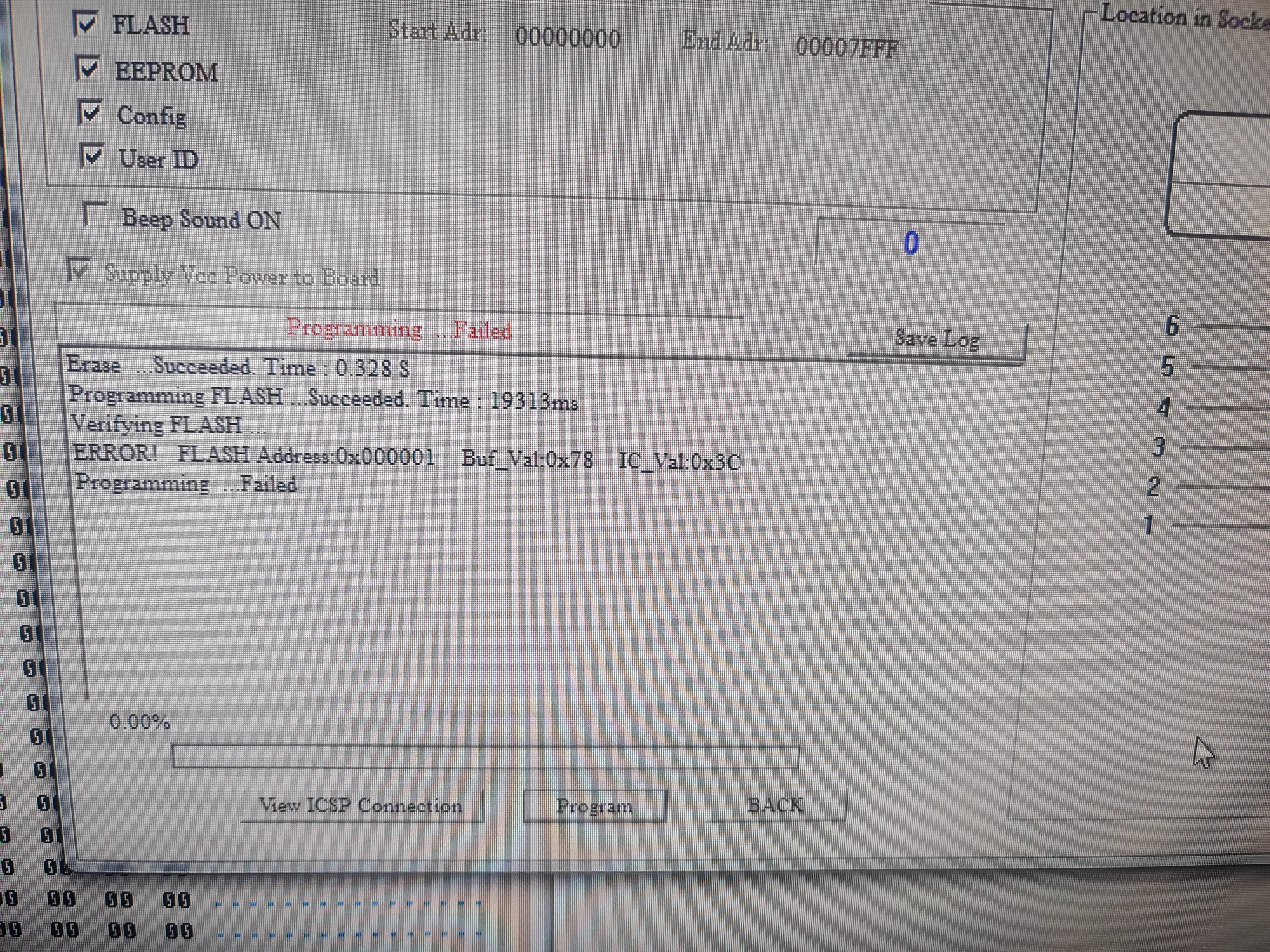

Can you please help me. I normally read all (flash,eprom,config) from this PIC, but i buy 2 same new empty PIC-s and i get this error when i try to write file that i read from working one. IMG_20230616_154914_50.jpg
Thank you very much. Its all working now. I made such amateur mistake like i program it for first tim. Im was totaly  confused and leaded by pic marking from datasheet. i was totaly forgot about dot on chip, because i was frustated. 😂😂
The position of the concave point is PIN1
Just to menti rsz_img_20230527_143949.jpg on that chip is desoldered and its directly conected to ICSP pins on TL866II plus. So i dont know what is the problem. I try everything but without luck. And chip is working and not damaged, but i cant read it for some reason . Hope for fast help from Admin or someone else. Thank you
