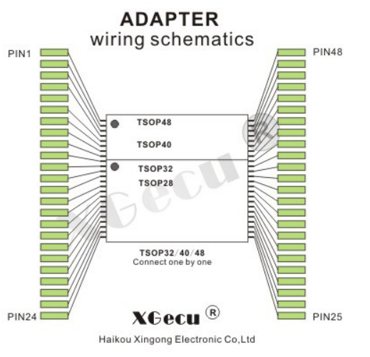

NAND wiring diagram for T48
How can I wire a NAND IC to T48 programmer?
Please send a basic diagram that show which NAND pin connects to which T48 pin.

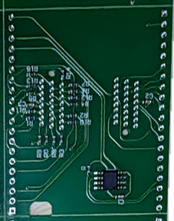

I subscribe, I asked for the same and there is no information available yet. I was very disappointed that XGecu decided not to publish this information, moreover, the manual for T48 does not exist. A schematic or reverse engineering of ADP_F48_EX-2 adapter would be really appreciated by everyone.
Is there anyone in the community that owns the ADP_F48_EX-2 adapter and can do a reverse engineering of it?
It is not complicated, that small chip on the back ("encryption" chip) is most likely an I2C eeprom used for adapter identification, it can be read easily.
Thank you, that would be a great help for the community.
I ordered the adapter and I promise to reverse engineer it and publish for everybody but I need to wait 3-4 weeks to get the adapter.
I'm referring to TSOP48  NANDs, low speed, used in routers, There is a diagram for T56 (see attached), I need the same but for T48 programmer.

The fastest speed for programming NAND on T48 is 6-10MByte per second. There are process requirements for making circuit boards, and customers are not allowed to make the adapter by themselves. There is also an encryption chip on the back.
