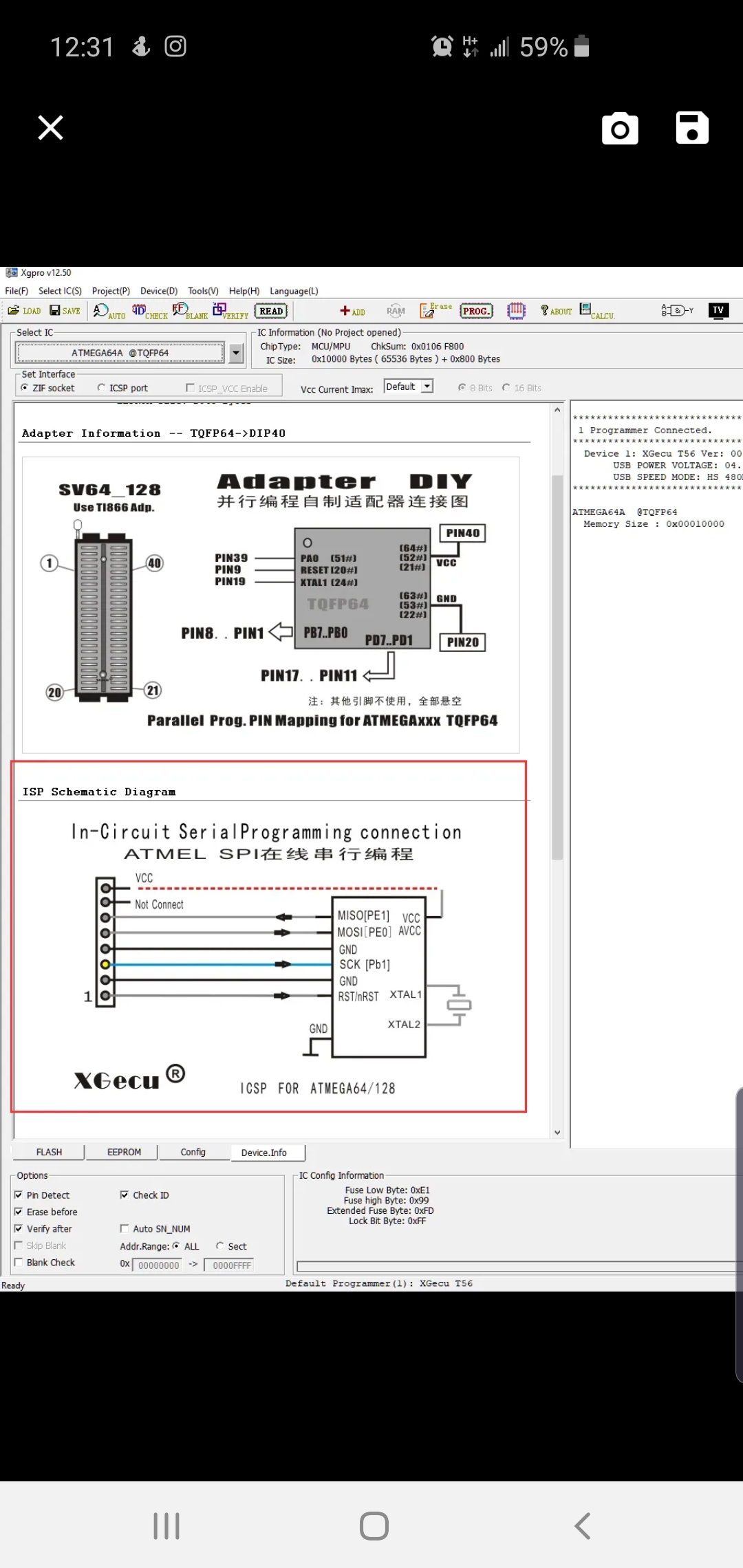

i have problem to read chip atmega64A IN XPROG BOX V6.12 WITH XGECU T56
I connected 7 wires according schematic(reset,gnd,sck,gnd,mosi,miso,vcc)

If you use ICSP Port you must check "ICSP-Port" on the Top where it named "Set Interface"

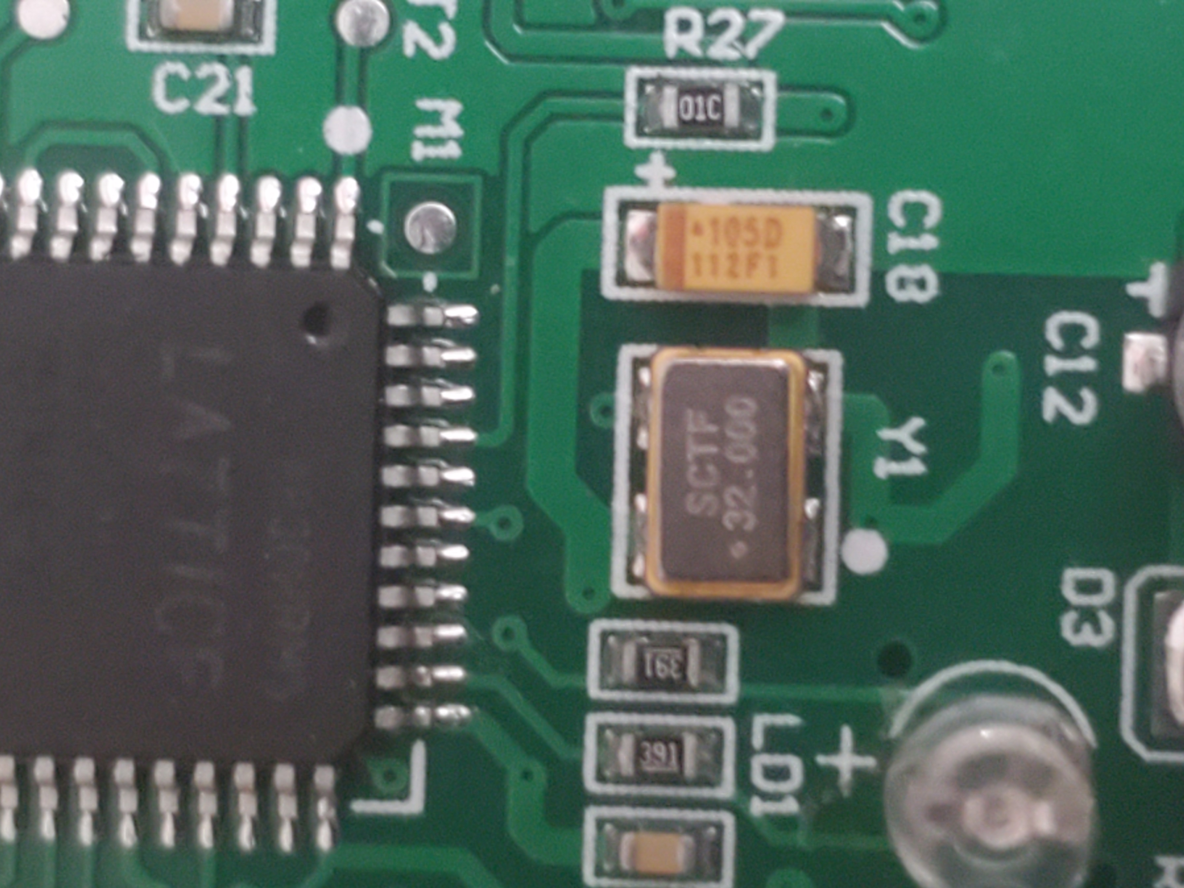

Upload the connection diagram. And photos
Is there a connected crystal oscillator?
