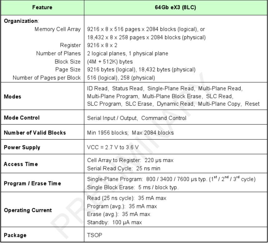

I have been trying to manually add a chip definition for the Sandisk SDTNPNAHEM-016G, but have had no success. I am using the settings gotten from the datasheet for the 008G model and increasing Page Size to get the larger chip.
XGecu crashes at various points during the read/verify phase on reading the chip. I have created both profiles for both the 008G and the 016G cersions but XGecu crashes on both.

Attached is the Technical Specifications of the 008G version.

I got it wrong. I thought it was an EMMC, but it was actually a NAND chip. Please give a screenshot of the error when reading.
As far as the error, it is just Verify Errors. Sometimes it goes through all of the sectors, and sometimes it is just on a couple hundred. When I dump without verify, I get no data in the dump. just pages of of 00, FF, 33, etc.
The crashing gives no error. the app just closes. Sometimes I have to powercycle the T56, and sometimes I do not. Crashing might be due to trying out different settings that the reader cannot handle. I can send you logs, if there are any.
Current Settings (Adjusted for the 016):
       PageSize :  16384
      SpareSize :  1024
Pages Per Block :  512
    Blocks Size :  8192KB + 512KB
   Total Blocks :  2084
    Device Size :  16GB + 1042MB
      Bus Width :  8
       nCE# Pin :  1
       nRB# PIN :  1
Is there anything that can be seen that I set up incorrectly in my settings, vs the datasheet?

this is 64Gb (8GB) memory:
Test:
PageSize :  16384
SpareSize :  2048
Pages Per Block :  256
Total Block : 2048
or
PageSize :  8192
SpareSize :  1024
Total Block : 2048
Those settings did not dump the NAND correctly either.
