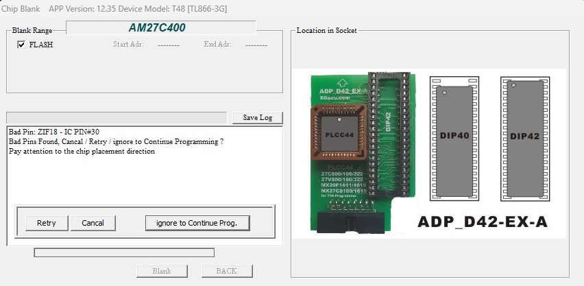

Toshiba TC574200D
Hi all, i have the T48 programmer and cannot find this chip in the device list. Can anyone help?

发表于 2022-11-8 09:01
scrappysphinx
it is same as AM27C400. (Disable ID Check)

scrappysphinx
发表于 2022-11-8 23:06
Hi, i tried them as 27c400 but i keep getting an error about bad pin Zif18 Pin 30. I can blank check, read and write them fine with my GQ4X programmer. The adapter is fine with an actual 27c400

scrappysphinx
发表于 2022-11-8 23:26
Never mind, i jumped pins 11 and 30 (both VSS in the datasheet) and XGPro blank checked, wrote and verified the chip fine
