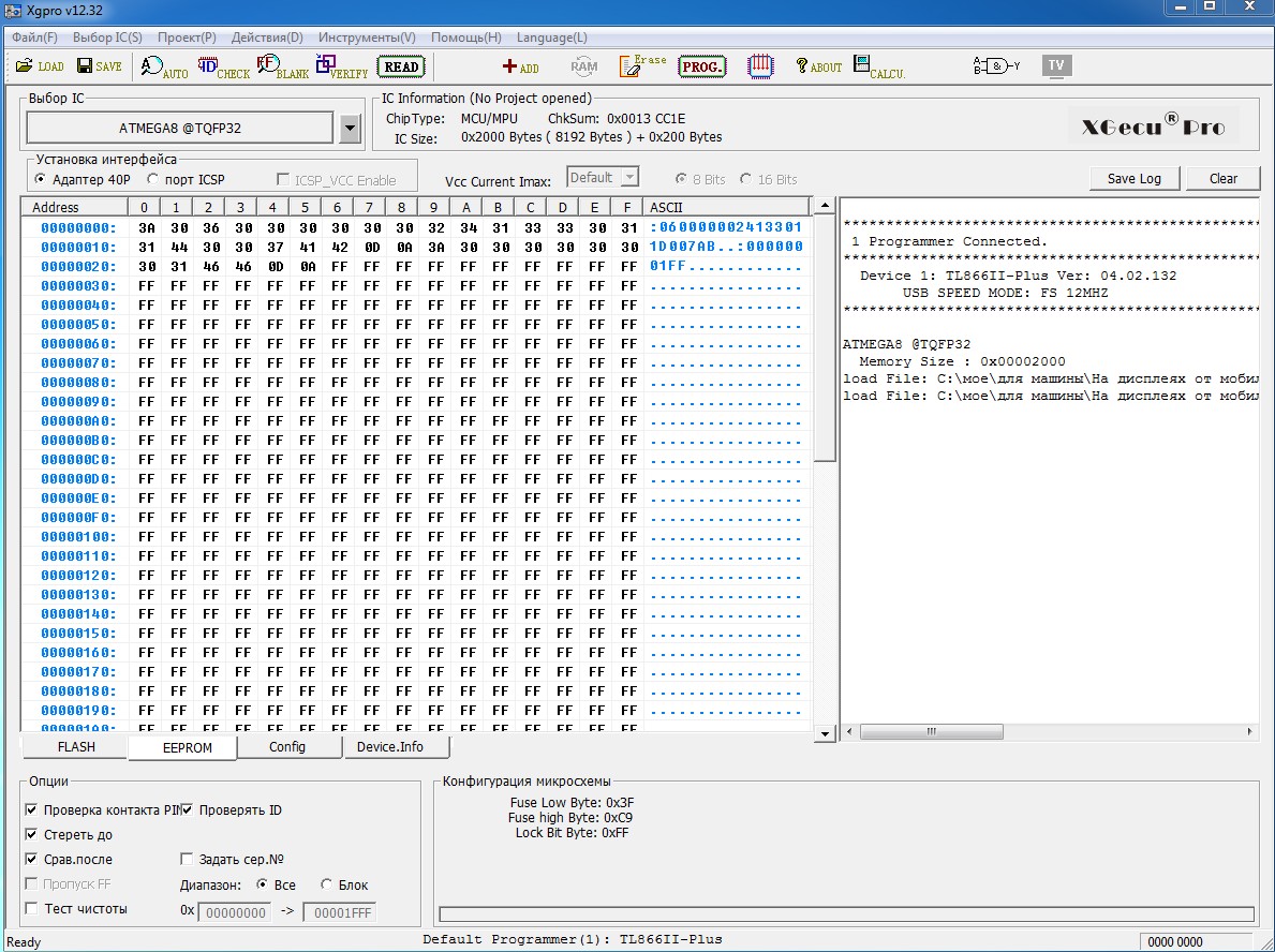

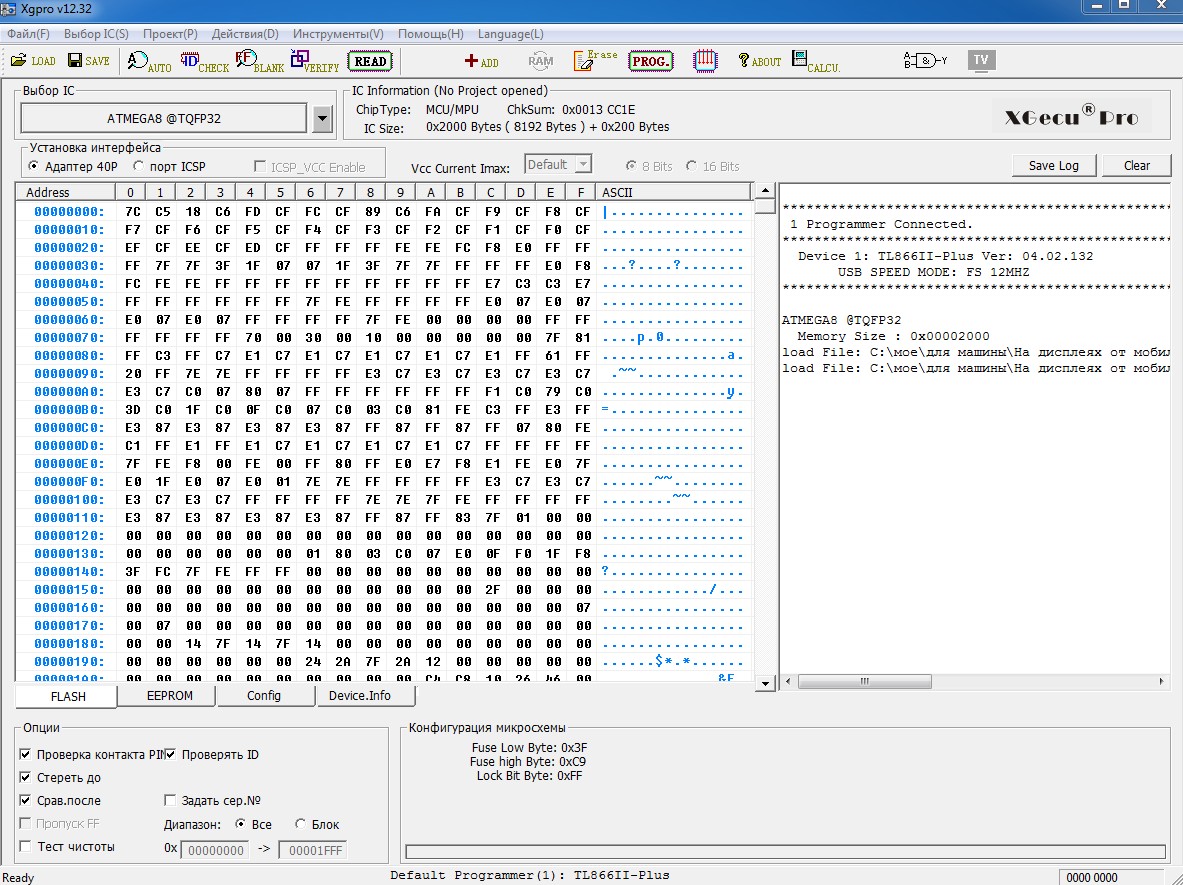

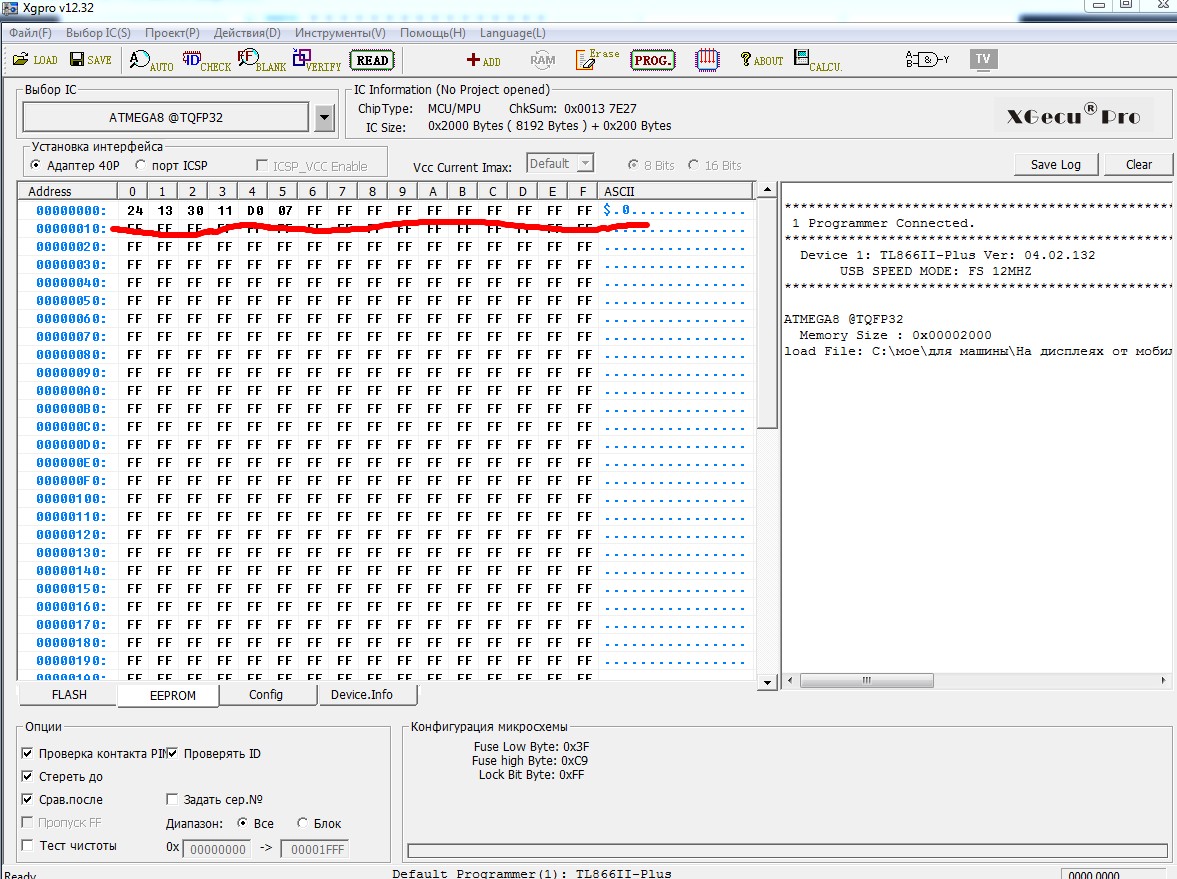

I can conclude that the program correctly reads the eeprom from the atmega chips, but the program ca ...
tomas37 发表于 2022-10-20 22:41

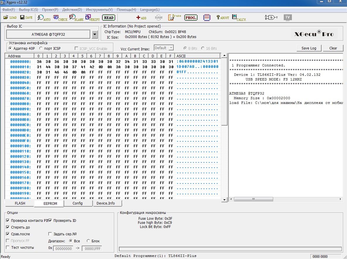

Hello: Have you tried to open the EEP file , using 'INTEL HEX' mode?File Load options, choose the EEP file, in the file format (left) change to INTEL HEX, and press ok. |
