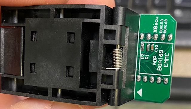

Can not read EMMC chip
I have tried all of the auto configurations but have not been able to read any number of chips that I have tried - they work in other readers.  I have the BGA169 adapter and I always get the message when try either Analysis or Read - nothing seems to work for EMMC chips.

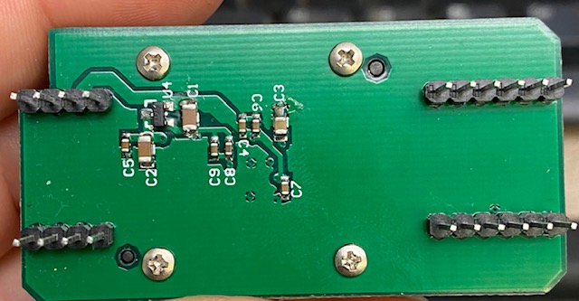

The chip is a SanDisk SD1N51-4G and SDIN8DR1-16G - both chips read just fine in other simple EMMC readers that plug into a SD card type reader.  I have now updated the software and the firmware with no change. IMG_5496.jpg IMG_5497.jpg

There is not much to the adapter but I am pretty sure there is something wrong with it - it has never worked - it clearly is able to see when a pin is not making contact as once in a while I will put in a chip and it will tell me a pin is not making contact, reposition and it passes.  I am sure it is not a problem of the part just not being in the PDF - there is a standard for reading EMMC chips and these are just run-of-the-mill chips, I have hundreds to choose from.  It does not get past the first command, I will have to scope out the power, CMD and CLK.  In the mean time I have ordered the version 2 of the adapter - it looks pretty much the same to me, maybe a few more pins - probably making up for skimping on the first go-around.

Hello: You can also remove carefully the socket screw's below, remove socket carefully and clean it below and pcb. Also clean inner pins with a cotton swab. Mount it again the very same way. Or only clean above if enough, as many Ics can contaminate contact pins and need cleaning. Notice, in the photo, some contamination near the pins of programmer. V2 of adapter permits to reach higher speed reading for those ICs that allow, and better shielding. Black PCB , as don't know the V2 adapter you order, maybe also offer  a bit more reliable operation. I only order now from xgecu store, because of problems that start over in transportation, bent pins due to not enough packing material, the warranty that test all adapters, so far so good no claims, and support.  Hope it helps  :-)

this is a bad adpter!  the wrong is C10 , c10's color is not right, it is 0.1uf . normal is 15P .
remove it and test.
The capacitor measured 170nF, removed and now...WORKING!
Thank you, I have the version 2 coming in the mail but now I get down to what I needed to do.
