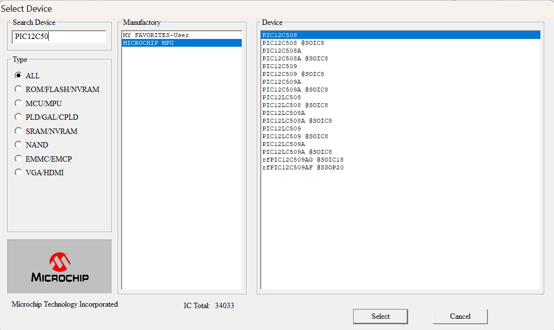

when will add to T56. T56 missing many microchip that t866 have. weird
madkingmy 发表于 2022-7-5 07:38
As an user..... It's indeed strange, as it's present in search on both T48 and TL866II, but did not show up in T56 search. It seems, maybe I'm wrong, that was forgotten to add
on search but seems present, when selecting it with no programmer present in TL866II or
T48 mode at start , closing the program, restart it in T56 mode, and without searching again,
it maintain PICxxxxx from previous selection,reading the position off IC on DIP, changes
from top (TL866II and T48) to bottom on T56.
For sure Admin will correct this issue. In the mean time you can, eventually test. :-)
New version for XGpro 12.x will be out soon.
Unfortunatly XGpro ver 12.05, out today still show the issue... :-( |
