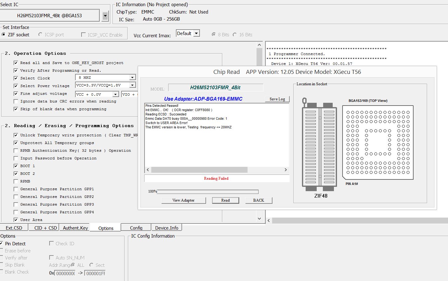

H26M52103FSR Reading Error
What could be wrong? The error log is:
PP Version : 12.05   Model : T56  MFG:2022-03-06
Device : H26M52103FMR_8Bit @BGA153
Pins Detected Passed!
Init EMMC... OK!    ( OCR register: C0FF8080 )
Reading ECSD : Succeeded
Failed  -- CMD No Responed Status: 00000980 Error Code: 1
Switch to USER AREA Error!
The EMMC version is lower, Testing  frequency <= 20MHZ
Is a 7 year old TV but if I can not read the chip, I have to put it in the garbage, main board is mo ...

Is a 7 year old TV but if I can not read the chip, I have to put it in the garbage, main board is more expensive that the TV value. Thanks
回复 3# lumina
EMMC is bad and is often found,  this is a old chip.  EMMC version is low.
4 bit and 1 bit same error, 1.8 volts same error, see picture.
Log:
APP Version : 12.05   Model : T56  MFG:2022-03-06
     Device : H26M52103FMR_4Bit @BGA153
Emmc Data DAT0 busy 000A__00000980 Error Code: 1
回复 1# lumina
   Test with 4b or 1b with low speed. (or VCC=3.3/3.3V)
