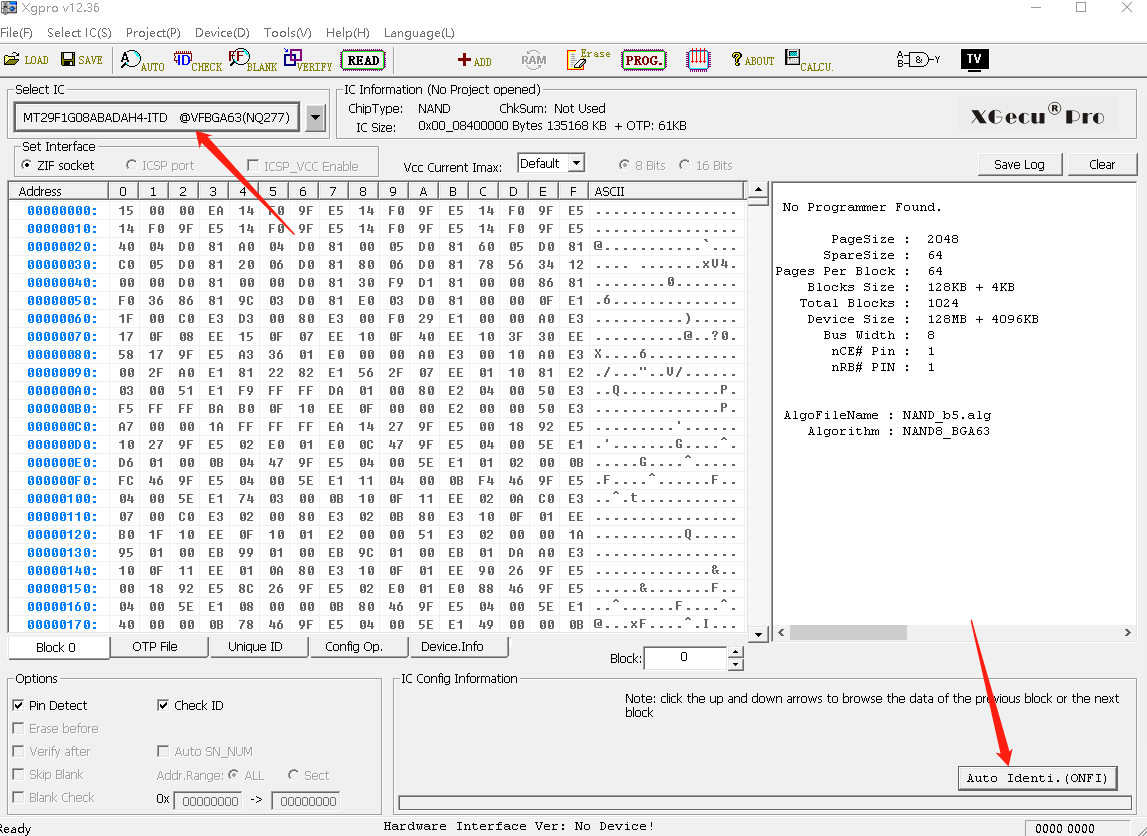

How to read this JS27HU1G08SCDA (bga63)?
Please, add a way to read this memory: JS27HU1G08SCDA (JEJU SEMICONDUCTOR).
I have Xgpro and T56 and don't recognize.
Thx

回复 3# frankviana
   There is no specification datasheet, and it can't be added. If you are a user, you can apply from them
you can select MT29F1G08ABADA @BGA63
and click [auto indenti] ,if it is an ONFI standard chip. you can read and programming it.
I'll try and post here.
Thanks
READ OK.
Thanks
