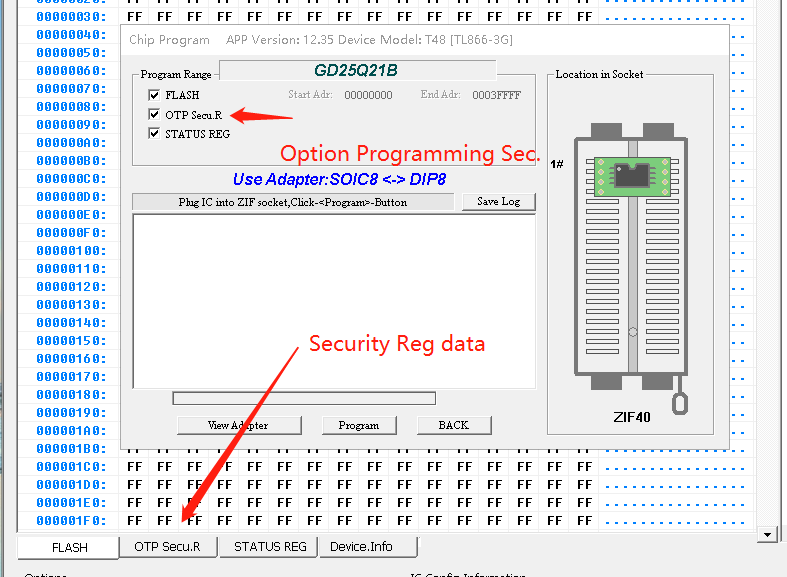

For T56 this issue looks like 25 series not fully supported. Do you plan to add security registers functionality to futher software release for EACH 25ser chips?
回复 3# vladi552
  miss Secu.reg progamming in  GD25Q20C/40C/80C/16C .
  fixed in next version.
