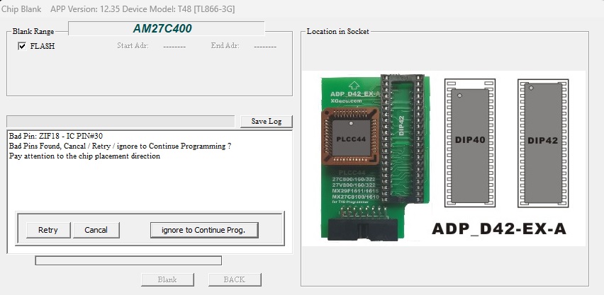

Hi all, i have the T48 programmer and cannot find this chip in the device list. Can anyone help?
Datasheet is here
https://datasheetspdf.com/pdf-file/610221/Toshiba/TC574200D/1
Thanks

it is same as AM27C400. (Disable ID Check)

Hi, i tried them as 27c400 but i keep getting an error about bad pin Zif18 Pin 30. I can blank check, read and write them fine with my GQ4X programmer. The adapter is fine with an actual 27c400

Never mind, i jumped pins 11 and 30 (both VSS in the datasheet) and XGPro blank checked, wrote and verified the chip fine
