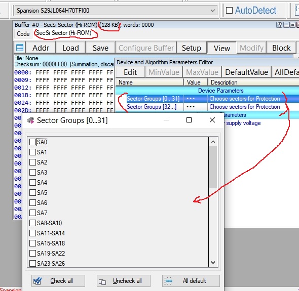

The first and main drawback is the lack of support for blocking and unlocking memory sectors, reading/write SecSi(HI-ROM) Secured Silicon Sector
Flash Memory Region.
A specific example In the figure from another program.

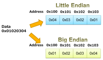

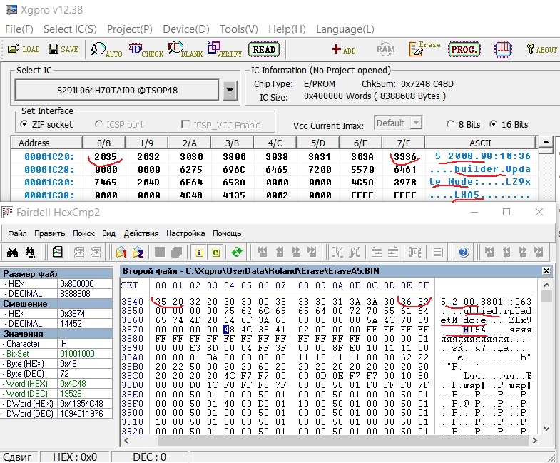

The second drawback is that there are no functions for exporting or saving a bin file with the choice of the format "Little endian and Big endian"

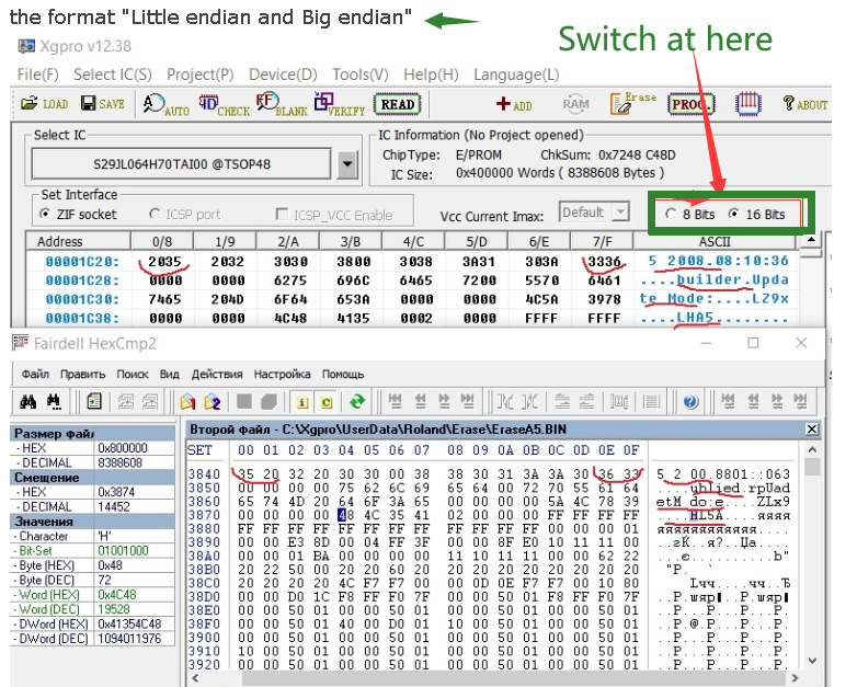

回复 3# Viperam

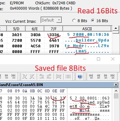

I didnot unstand you .This is only the switching of 8-bit 16 bit display mode.the file your saved is same of course.

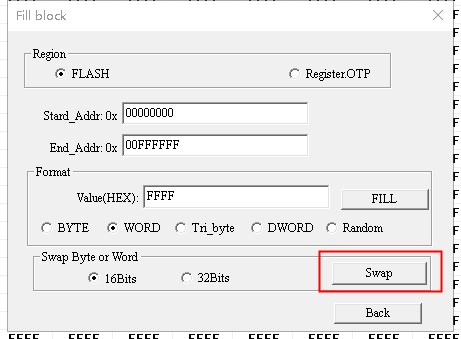

if you want swap buffer.
use fill block funtion as follow:
回复 2# admin Switching 8bit to 16bit only works with the Xgpro buffer. If you save the buffer to disk, it still saves as 8bit Although the data was read as 16 bits...

1. Lock and unlock funtions can be added later.
