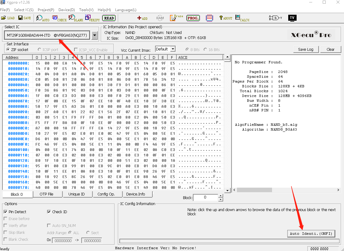

How to read this JS27HU1G08SCDA (bga63)?
Please, add a way to read this memory: JS27HU1G08SCDA (JEJU SEMICONDUCTOR).
I have Xgpro and T56 and don't recognize.

   There is no specification datasheet, and it can't be added. If you are a user, you can apply from them
you can select MT29F1G08ABADA @BGA63
and click [auto indenti] ,if it is an ONFI standard chip. you can read and programming it.

I don't have the datasheet and I don't know where I can find it. I already searched in several places.
I found ony pdf and some memory inside:
http://www.jeju-semi.com/Products/NandFlash
http://www.incmicro.com/img_up/s ... uide_jsc_ver1.0.pdf
