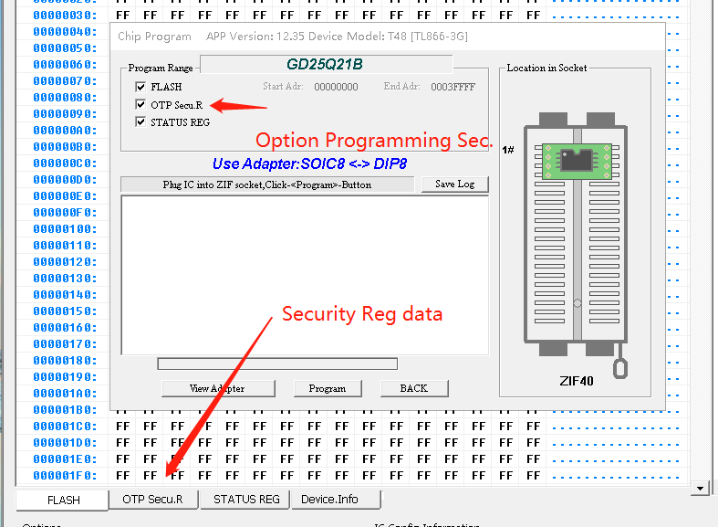

  miss Secu.reg progamming in  GD25Q20C/40C/80C/16C .
  fixed in next version.
