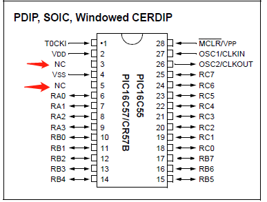

When I read a PIC16C57 I have error PIN 3 and 5 are not connected.

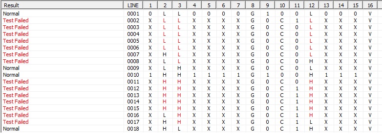

When I do a logic test on a CD4021, the chip is not recognized by the T48.
When I do the logic test with CD4021 on my TL866II, it works without problems.

Thanks for the 4021 solution! It's working fine.

    CD4021.lgc (2.48 KB)
4021 fixed .
import this file.

1. PIC16C57:
I disabled [pin Detect]. Then [Read] the data of the chip with my TL866II and with my new T48.

2. HEF4021BP:

1.PIC16C57 Pin 3/5 is Not Connect,  can not be detected . you can disable [pin Detect] in Options.   T48 Pins sets of PIC16C57 is wrong. will be fixed in next version.
2. Please you upload a picture of Testing 4021. (not AUTO FIND)
