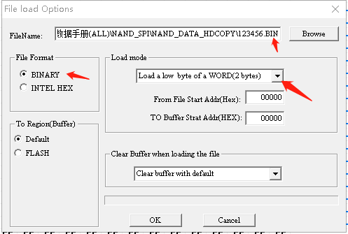

How to split .HEX to LO and HI?
I have a .HEX dump and the instructions are following:
"2x 27C256 are required, The hex file has to be split up in even/odd bytes to obtain High byte/Low byte"
Question:
How do I split or burn a .HEX to 2 x 27C256 with the XGpro software?
Example attached:
Hex.zip (38.75 KB)

right!
admin 发表于 2022-10-30 14:38
how do I then split it into 2 x 27C256 of HI/LO?
回复 3# teevee
right!
回复 2# admin
Thank you and then I will have a .bin file instead of Hex, how do I then split it into 2 x 27C256 of HI/LO?
Since the guide says 2 x 27C256, then I guess the input should be 27C512.
回复 1# teevee
   HEX to BIN to file, and then load bin file
