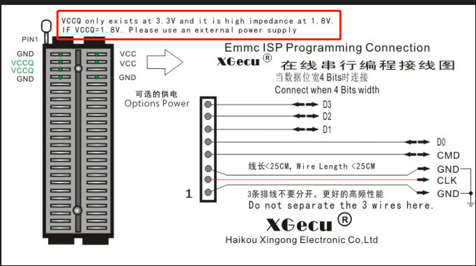

To correct! Instead of 1.8V, the voltage is 1.5V

may be into the box to make a modification?
回复  Oleg_Skalskiy
AMS1117-1.8V  is Is inappropriate.
need a LDO as XC6206 1.8V
Hand mode VCCQ 1,5V 🤔
Test 发表于 17-10-2022 04:19
    I installed AMS1117 1.8V on the adapter
But the partition manager is missing
+ Ready to be a tester!
Maybe you need some modification of the box? Here on the forum, most of the engineers will be able to fix it!
only at 3.3V power ,VCCQ is valid.
