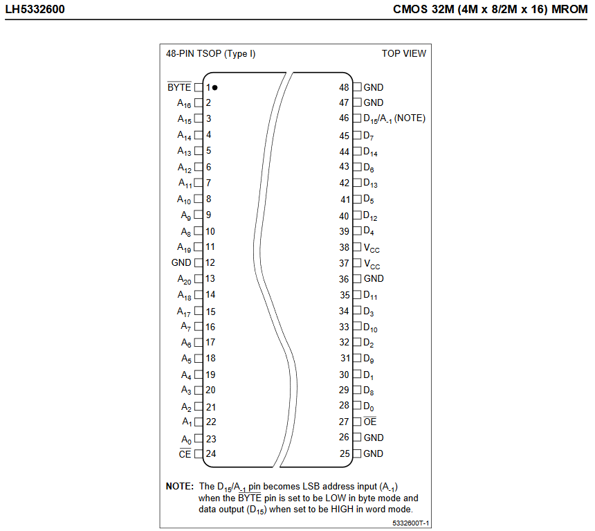

I have a Macronix 5V Mask ROM that I need to read which has a non-standard pinout, which as far as I can tell is very similar to this for the Sharp LH533 MROM series.
Can anyone advise a supported chip that I can select that will allow me to read its data?

This chip is same as MX23C3211,choice MX23C3211 to read.
This chip is same as MX23C3211, choose MX23C3211 to read.
Thanks! That worked :D
Actually it doesn't work quite right, because the MX23C3211 is only 4MB, and the chips I have are 8MB :'(

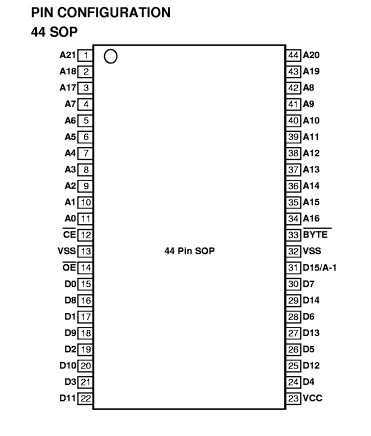

I believe I need MX23C6410 support, with the only difference being that pin 12 is A21 instead of VSS.
OK,we will add MX23C6411
Hi, Please add support for the SOP-44 package for the MX23C6411

回复 5# adminhi add mx26l6420mc sop-44 for programmer t 48[color=rgba(0, 0, 0, 0)]MX26L6420MC-90   [color=rgba(0, 0, 0, 0)]MX26L6420MC-90
