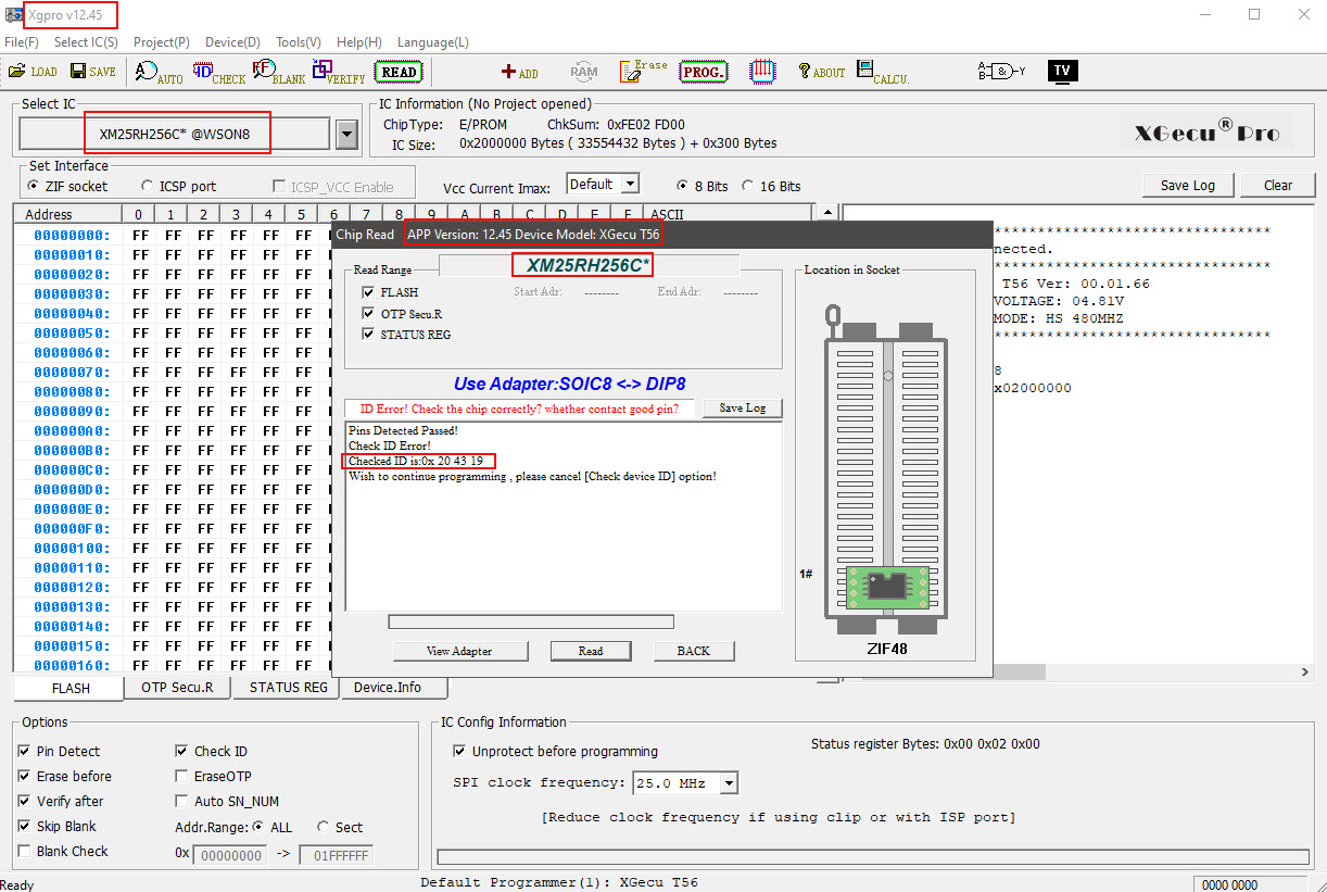

i try to unchek ID . i read dump but its crupted .... there is problem . i try w25r256 work perfect

   Hello,             I see now. Some times with so many IC variants, the ID present in the software,
is only from one IC, sometime something is wrong and need to be corrected,
and to work, need removing check ID tag, at bottom of window. Can you, please try it?
For sure, time permits, Admin will help further.

As a User: Have you tried latest software 12.45?
XMC 25RH256C* is available for all Xgec ...

  1. APP Version : 12.45   Model : T56  MFG:2020-10-27
  2. Device : XM25RH256C* @WSON8
  3. Pins Detected Passed!
  4. Check ID Error!
  5. Checked ID is:0x 20 43 19
  6. Wish to continue programming , please cancel [Check device ID] option!

    As a User: Have you tried latest software 12.45? Download Newest XGecu T56/T48/TL866II software(下载最新软件) - 编程器使用与软件下载 - XGecu Programmer Forums - Powered by Discuz!
XMC 25RH256C* is available for all Xgecu programmers. Any error? Post images, please!
