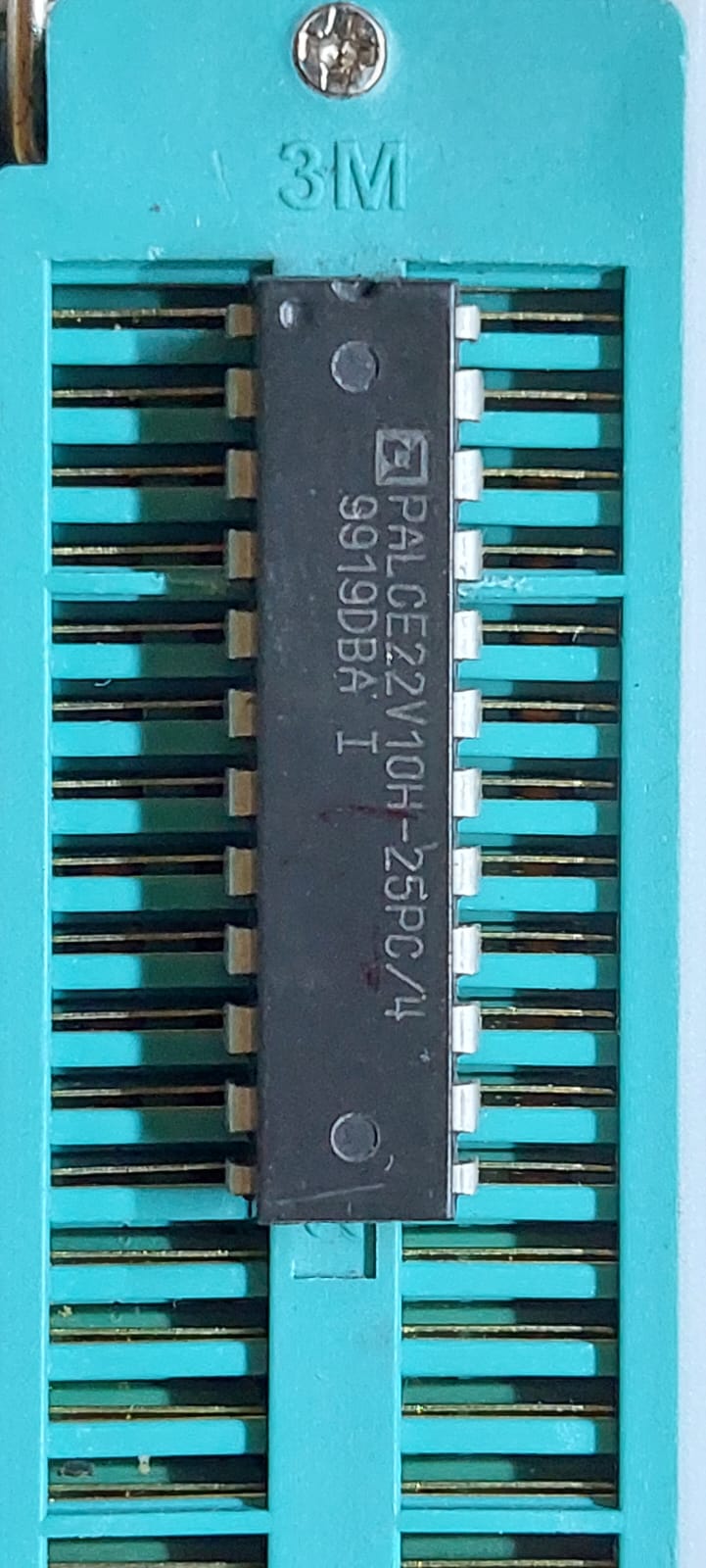

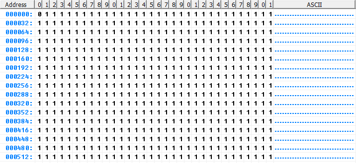

Hi, I am using TL866II Plus. I couldn't find 22V10H integrated at the database of Xgpro v12.15. If I search for remaining alternatives, I can only see 22V10_ variants but without exact "H" version. If I select one from alternatives and read the integrated, all addresses have "1". This is an error. Because of the error, I can't do any process.
Also, if I could; I loaded 2 pictures. One of them belongs the integrated, other is top of adresses. Adresses continues like that to the bottom.

   not support AMD PALCE22V10
Not: I wrote "0" at the first address manually.
