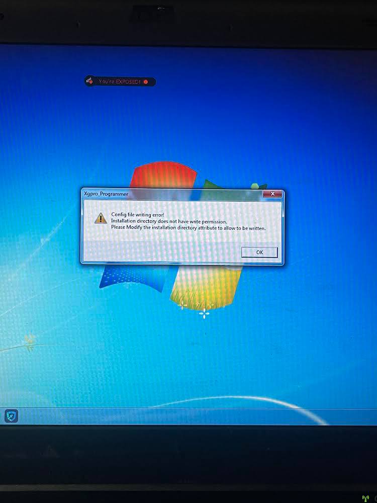

tl866II plus install failed config file writing error
config file writing error please help
photo_2021-12-05 16.54.15.jpeg (46.21 KB)
hi mate it's still not work
回复  lykimleng
window 8 32bit
lykimleng 发表于 2021-12-5 21:18
        As a user...Sometimes , problem is related to a certain user in the machine,
To avoid problems, copy the setup file to desktop, unzip it, and right click, and do the setup
in admin mode (run as Administrator). Try it :-)
回复 1# lykimleng
I really don’t know how to explain the problem further,
The prompt is already very clear.
try to install on other logical disks (D: E: F!
回复 1# lykimleng
window 8 32bit
