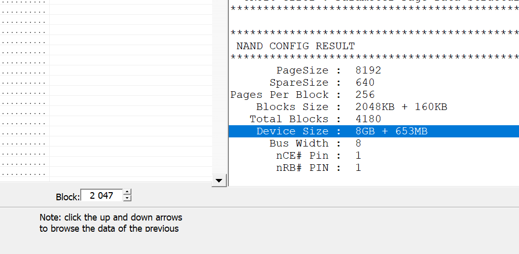

- crashes by clicking on "Add IC by user", cant find any log to attach- NAND H27UCG8T2ATR-BC https://datasheetspdf.com/pdf-file/845970/Hynix/H27UCG8T2ATR-BC/1
has 4180 total blocks
but using arrows I can reach only 2047 block number maximum.
(Manually I can't input any number from 0 to 4179)
Windows 11
and one more update
  • when I manually enter, for example block number 1000
  • then click on spinner arrow to go to the next block (1001) it jums to anywhre but not to the 1001 block
