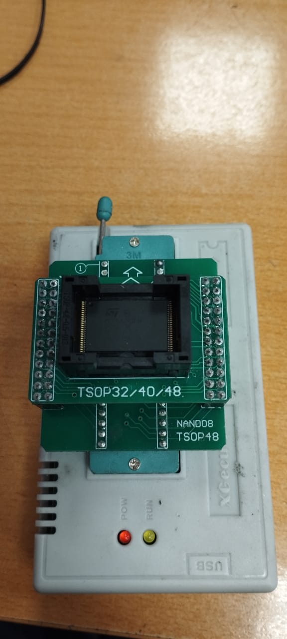

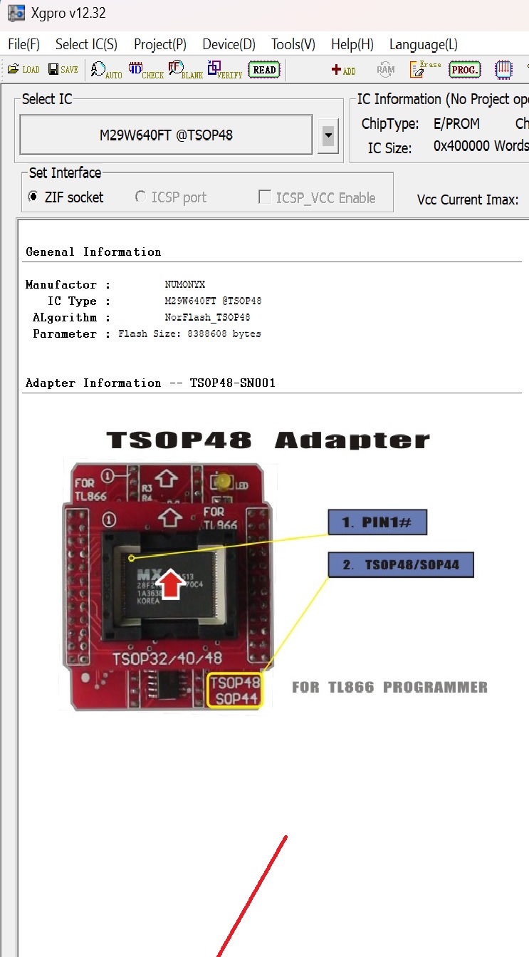

As a User: I think you may need support for M29W640FT, but not for M29W460FT as you write it,just guessing.

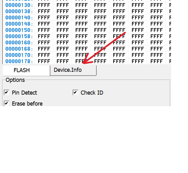

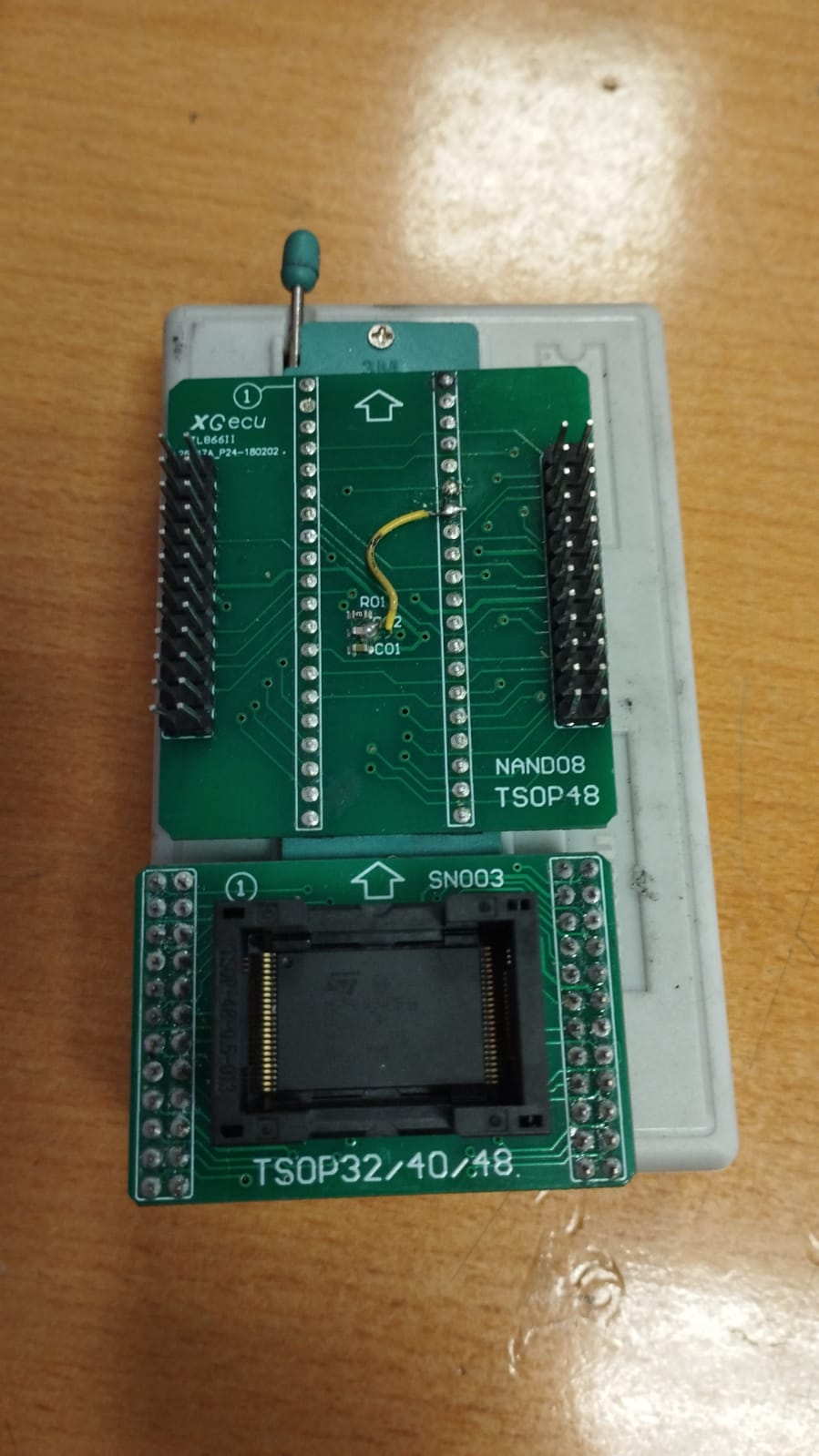

On TL866II if the guessing is correct, the information for adapter needed is in the tab Device info,
the base adapter is the one you need, you may need to remove the top adapter, and insert it in the
correct base adapter.
Post some pictures, may help
