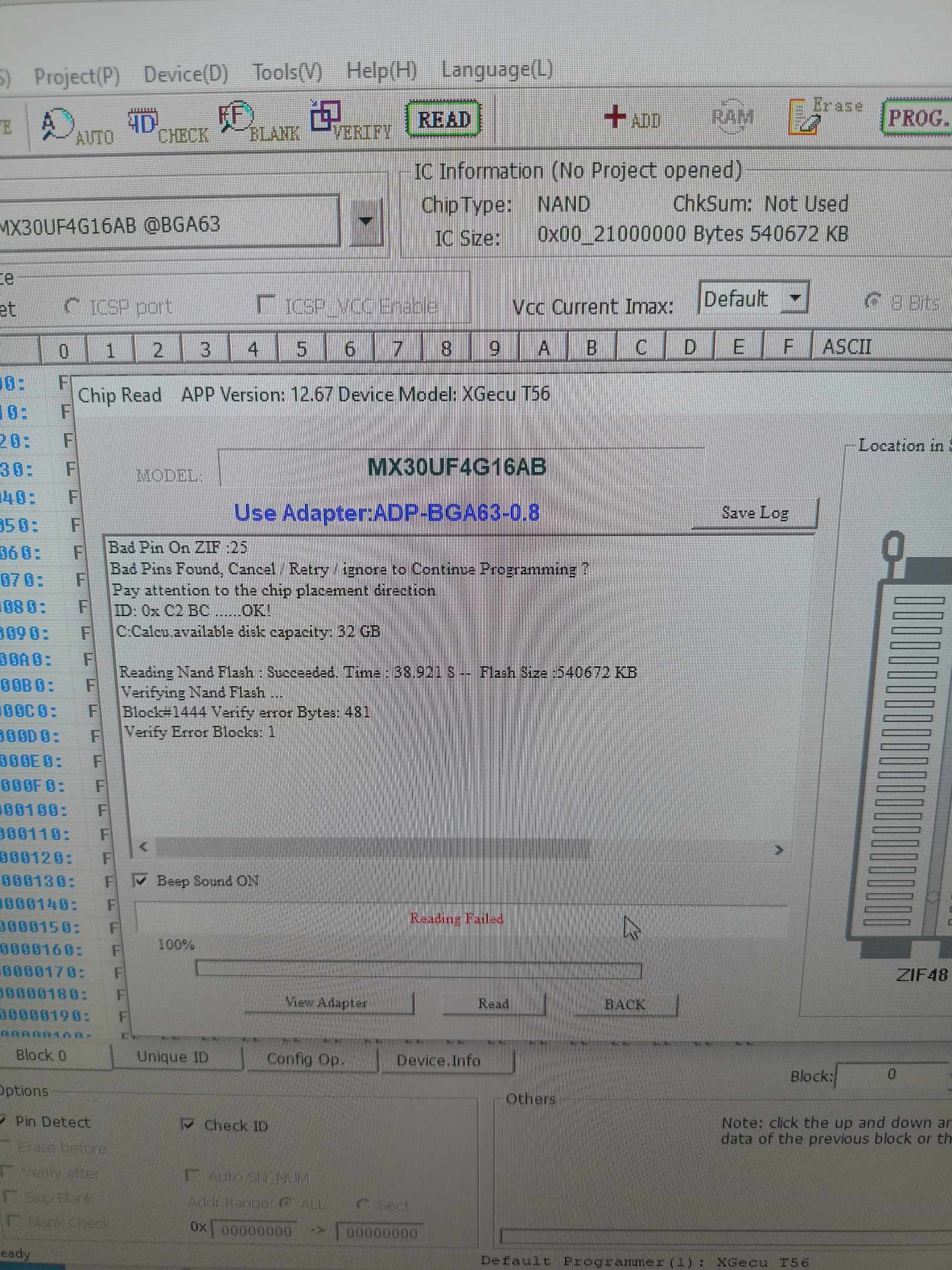

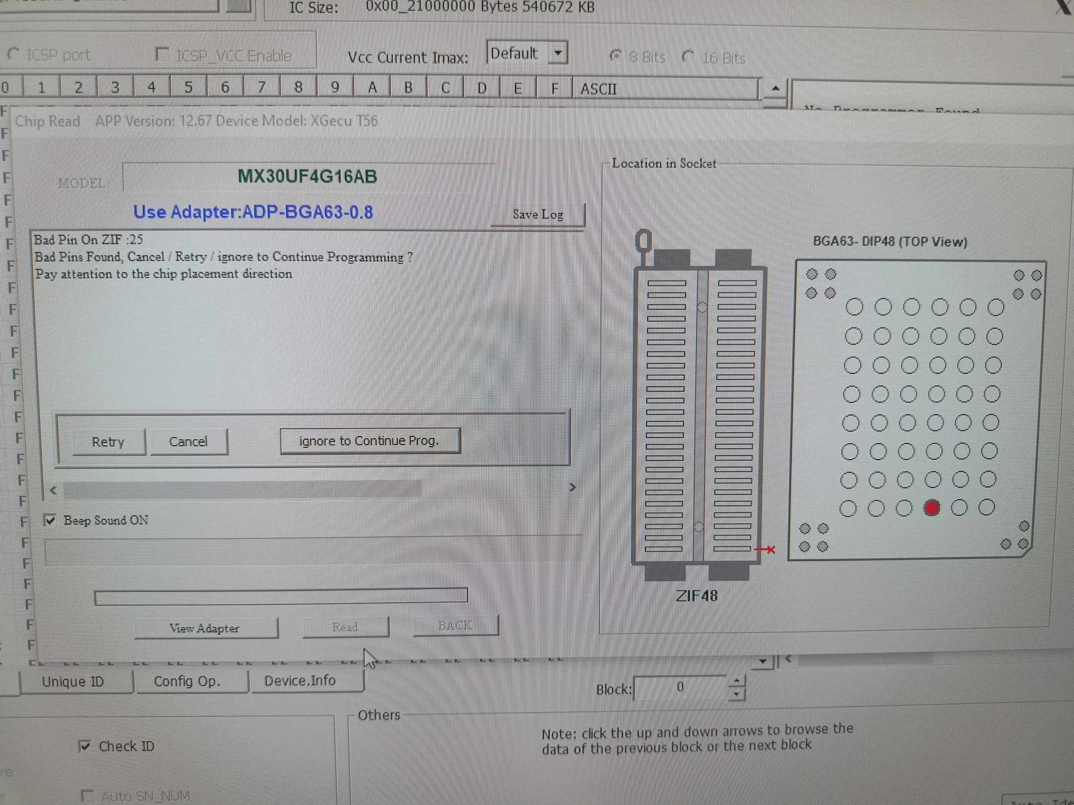

[quote]what to do? All dump FF
Dmitry 发表于 2024-12-19 18:36
Dear Dmitry,
Try latest known software HTTPS://www.hklrf.com/Downloadfile_59.html ,
with some corrected ICs. Why? You got one error with one address lines, you should got
multiple errors....
Anyway, if not help, please post your adapter, clean it ( just in case), if adapter socket is removal
capable, clean everything. No Good? Wait as T76 is almost out and a new software will appear.The IC used maybe have bad sector...

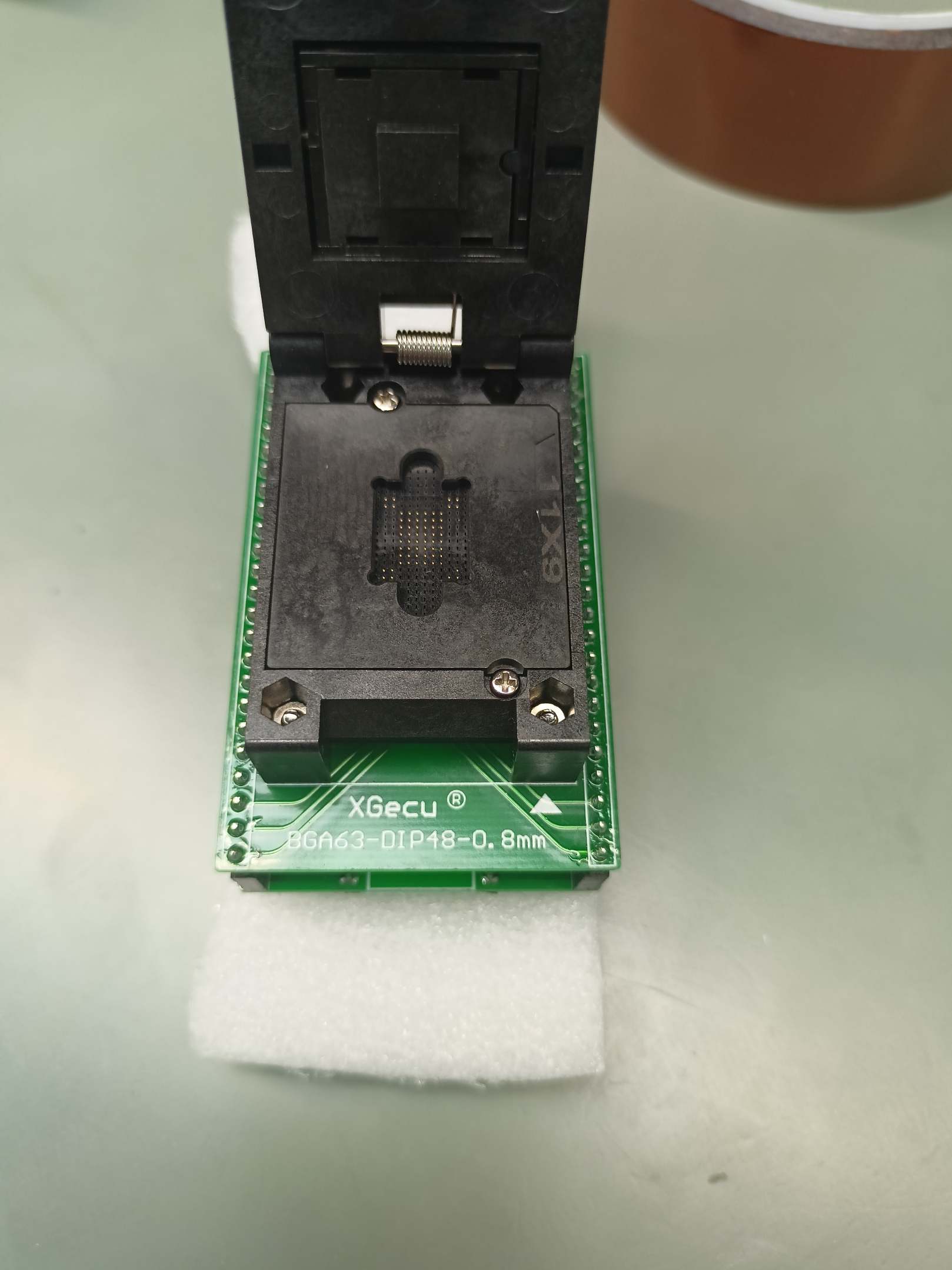

Albano hello, I use the latest version of the software, adapter, rang, all contacts are working. This contact on the chip does not ring anywhere, in my opinion this is the ground contact, I forcibly made a jumper to another ground contact, the error in determining the contacts disappeared, but nothing changed, the dump also remains empty (FF). Why there is only one error in the log I do not know, most likely the code for working with this chip is not finished. The chip is working, fully works in the device and does not fail. I do not understand why the programmer support does not respond to problems. I have another programmer, not xgcue, it reads this chip, but with errors, tech support advised me to read the documentation and play with delays.
Albano I tested, unfortunately came across 2 faulty chips, which gave errors in different places. Were replaced with new ones, but the contact error on them remained, just ignored, or make a jumper on gnd according to the connection compression of the adapter contact (only for this series chip)
Albano I tested, unfortunately came across 2 faulty ...

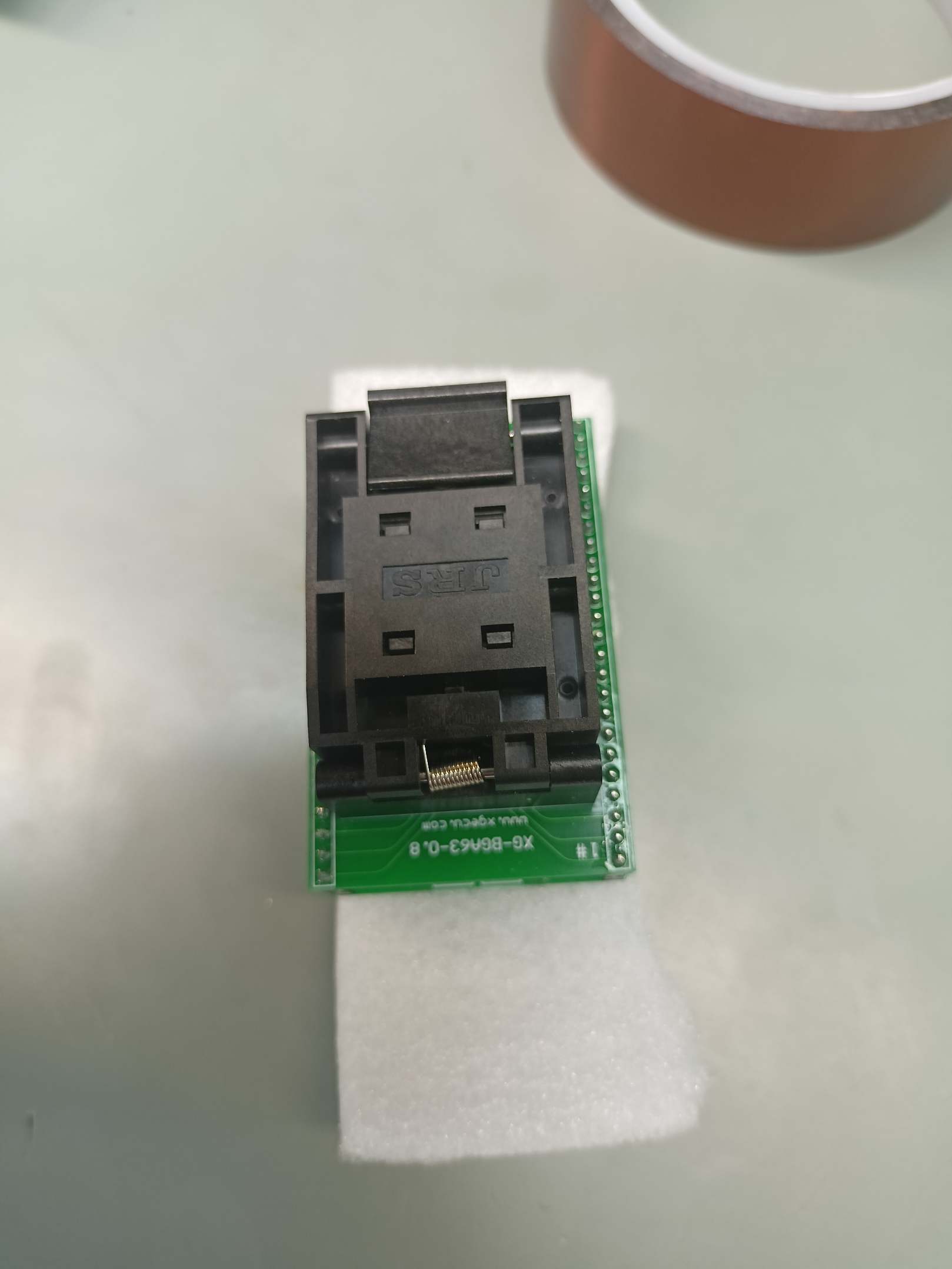

Hello, Thank you for share your findings and experience. Please post the pic of your adapter,
as 3 already exist for T56. Maybe Admin correct it , hopefully. :)
Ответить 6# Альбано.Матос
I ordered a regular adapter for the t56 model using the number in the app. About 2 months ago, so I think it hasn't had time to go bad)) This is some kind of problem with these chips
Ответить Альбано.Матос
I ordered a regular adapter for the t56 model using th ...
Dmitry 发表于 2025-1-13 23:34
Hello, or maybe the software needs adjustment. With all the data now here, software and socket
seems one of the originals from Xgecu, hopefully they fix it, or give a tip :)
