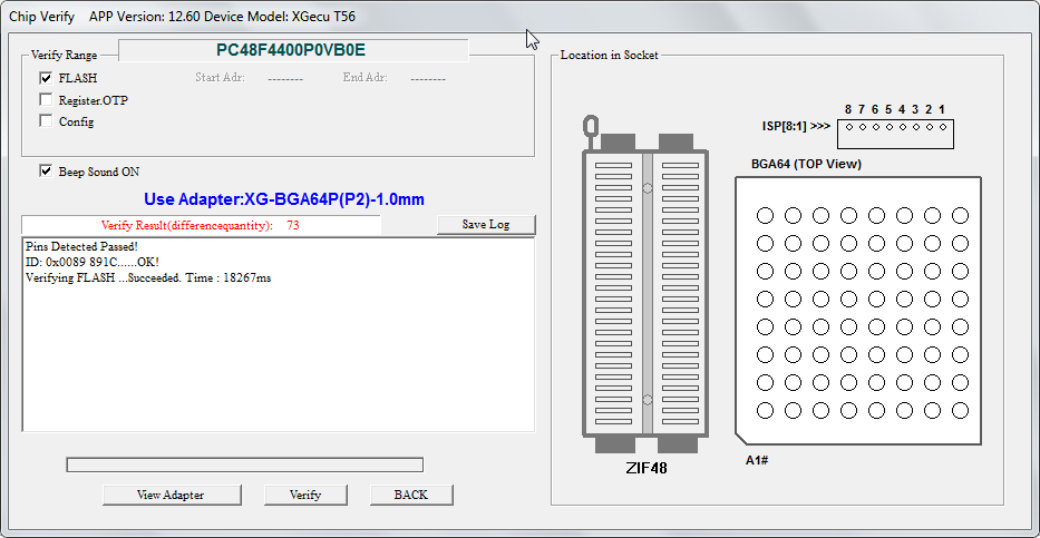

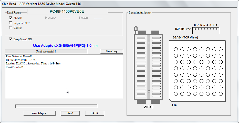

Unfortunately, I'm unable to read and verify PC48F4400P0VB0E (BGA64) with adapter XG-BGA64P2-1.0mm

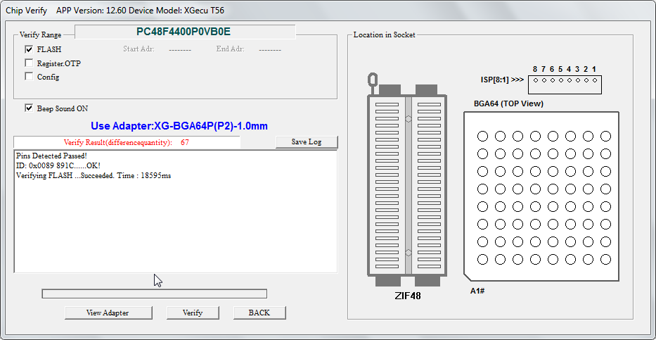

Each time of verify I have errors with different addresses (about 50~70 differences).
I send T56, adapter and IC to my supplier. Supplier checked IC on own T56 with adapter and also have random errors.
Maybe it makes sense to decrease clock speed in algo xxxP30 BGA64P (proposal from supplier)?

   This problem occurs on some chips and it is difficult to find the cause. My chip test did not show this error.
In my previous post about PC28F256P30BF (BGA64) I bought few ICs and I have same problem with new ICs.
My PC48F4400P0VB0E perfectly works with ARM CPU and vxworks OS, but doesn't work well with T56? Is it possible?
